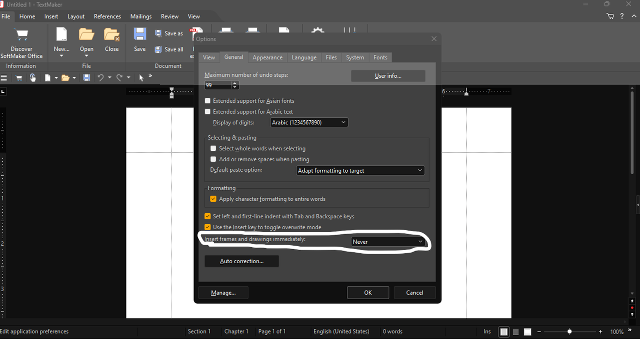

Re: Need Tips and Tricks Combining Photos With Text
It‘s in the general options, so it will work for all new documents until it is changed. If it is set to „Always“, all inserted images are placed in the upper left corner which is in most cases inconvenient (to say the least). Personally, I keep it at „Never“; this allows me to draw a rectangle with the mouse first in the (approximate) size and position I want before the image is inserted.
The screenshot below shows people how to turn off the Automatic Image Placement in Textmaker. (File...Options...General.) Setting this to "Never" as default in TextMaker will give you greater control over image mobility. Additionally, it is easier to use "Object Frame" rather than "Embedded Object" because you can move things around so much better! Thank you for your help! These tips will work for many people!Jossi wrote: Fri May 22, 2026 12:15 pm It‘s in the general options, so it will work for all new documents until it is changed. If it is set to „Always“, all inserted images are placed in the upper left corner which is in most cases inconvenient (to say the least). Personally, I keep it at „Never“; this allows me to draw a rectangle with the mouse first in the (approximate) size and position I want before the image is inserted.
Satch
