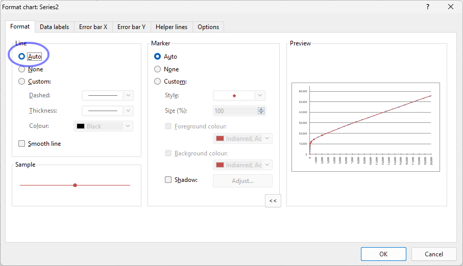

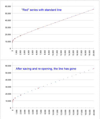

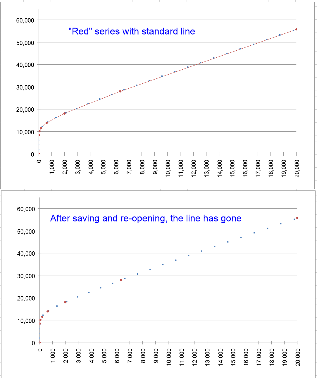

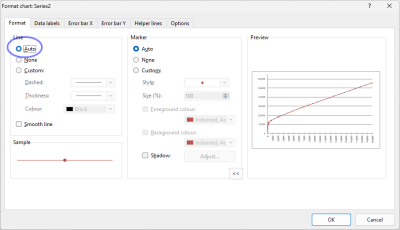

When you load the PMDX (attached), both series show no lines, just the data points. If I select the "red" series and enable the line, it displays correctly.
Then I save the file, close it, and then re-open it. The line has gone.

Line appears correctly until file is reloaded
Line selected for series

Right-click the "red" series on the chart and add the line
