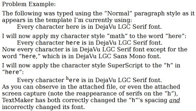

I created a character style “SubScript” and “SuperScript” so that I could subscript and superscript characters as I preferred, rather than as TextMaker prefers. Both character styles only contain changes relevant to subscripting/superscripting and are “based upon” “(floating).” Despite the use of “(floating)” and the assurances from the online (i.e. where it shouldn’t be) help, these character styles change the font too, if the font is not the default font of the paragraph.
Note that the above example is but one example, and there could be other issues.

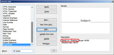

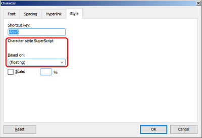

1. The character styles “SuperScript”, “SubScript”, and “Math” are all “based upon” the style “(floating)”, and not, as you wrote, “Normal”. Or at least they should be.
