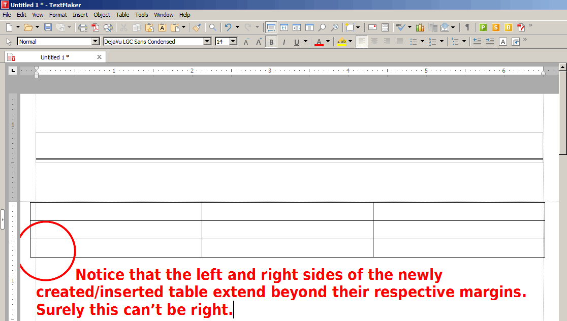

Greetings,
The table shown was automagically created by using the Table » New Table command (via the old skool menu system). You will observe that the table stretches beyond the left and right margins. I find this not merely irksome, but wrong.
The problem, if it be a problem, seems to result from the (IMHO) odd way TM 2021 is handling cell sizes. It starts with the cell width, then it expands the cell borders to allow space for the Table » Cell Properties » Format » Margins. Surely the cell width should be sacrosanct and TM should instead be reducing the usable space inside of the cell by the margins?
N.B. As I recall, a similar issue occurs when placing borders (“lines”) around objects. The enclosed object is not reduced to make allowances for the border (line) widths, but rather the lines extend past the object (and possibly the margins, etc.).
The table problem I reported above is only one of two problems introduced by the new (or at least newer) version(s) of TM. The second problem is TM’s intermittent refusal to change cell widths. The table dialog will accept changes to the Table » Cell Properties… » Format » Width, but the changes will not be applied when the dialog is closed. Because of its intermittent nature, I have not been able to document it [i]in flagrante delicto[/i], but I’m gunning for it.

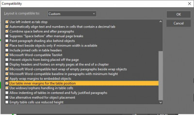

Posts: 4096
Re: Table Problem 1 of 2: New Tables Overshoot Margins
Thanks for sharing the problematic file and screenshots with complete details of the problem. I checked and found that this file is tmd which is our older version of documents. This one contains compatibility settings due to which table is following the different margin scheme.
Please follow these steps to resolve this problem:
1. Open this file in TextMaker.
2. Click on menu File > Properties... > View Tab > Compatibility... button.
3. Scroll down, and you will find 5th setting from the end is "Use table inner margins for the table position" checked.
4. Uncheck/disable it.
5. Click OK on both the dialog box and then try to insert a new table.
Please check the below screenshot for your reference.

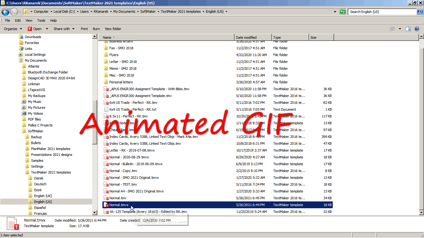

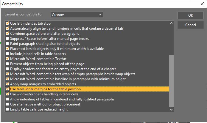

Your directions work fine on a per file basis. I cannot, however, find a way to make the table compatibility setting the default. The setting doesn't seem to be saved in templates, and TM seems to forget about the changes I make. Again, the change seems persistent when applied to a particular file, but not anywhere else.
For example:
Bonus unsolicited suggestion: it would be swell if the settings were documented somewhere. I could not find them in the .CHM help.
Cordially,
Richard
Normal (Default Template) - Table Compatibility Setting Forgotten.tmvx
(17.42 KiB) Downloaded 4884 times

Thanks for trying the steps and for sharing this new template file. I want to mention few important points here to clear some confusions:
1. I have tried you this template and found that this template as well as files created from it have the mentioned setting. So, you can make this template as default template and after that all documents will follow it.
2. But as you are already using SoftMaker Office 2021, the above suggestion is not good because TMD file from which you created this template is actually very old file format with outdated features.
Currently, we have TMDX file format with no compatibility issues. So, I suggest you to create a new file/template from scratch without using that TMD file.
