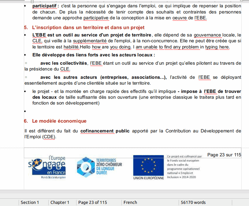

Thanks for sharing the sample file, but we are unable to reproduce this problem.
I even copied and pasted pages from your file to make it 115 pages long, but even then I am able to type without any problem. Please check the below screen recording for your reference.
There should be something else which can cause this problem. Please update your SoftMaker Office to the latest version.
You can also try to rename SoftMaker folder which is in your home folder. Please don't delete this folder.
