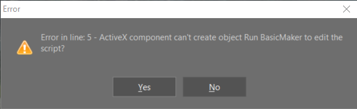

Re: CreateObject now not working
Thank you for your response and I attach the error picture.
I must emphasise that nothing has changed on my computer and I have not edited or changed the BasicMaker script, I simply installed the v2021 when I purchased it and ran my accounts as normal only to have it fail as described.
Thanks for sharing the screenshot. I was unable to reproduce this problem but I have forwarded the details to our development team. Meanwhile, please share the script file which you are trying to run.
1. Ensure that the file PlanMaker.tlb exists in Program Files\SoftMaker Office 2021.
2. Reinstall SoftMaker Office. Maybe something has messed up the registry settings.
Oh, that won't work. For OLE Automation to work, it needs to be properly installed in the Windows Registry. Portable apps don't do that.
Thank you very much martin-k, all is now well.
Most likely this was so because your regular install created the registry entries, and since portable PlanMaker was already running, BasicMaker switched to it instead of starting the regulary installed version.
