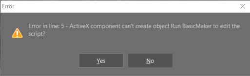

Thank you for your response and I attach the error picture.
I must emphasise that nothing has changed on my computer and I have not edited or changed the BasicMaker script, I simply installed the v2021 when I purchased it and ran my accounts as normal only to have it fail as described.

Thanks for sharing the screenshot. I was unable to reproduce this problem but I have forwarded the details to our development team. Meanwhile, please share the script file which you are trying to run.
