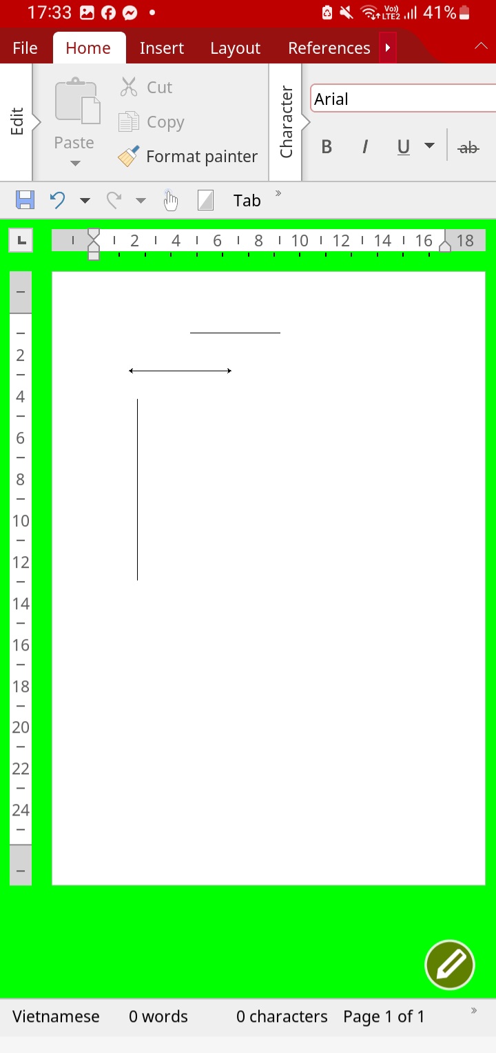

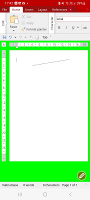

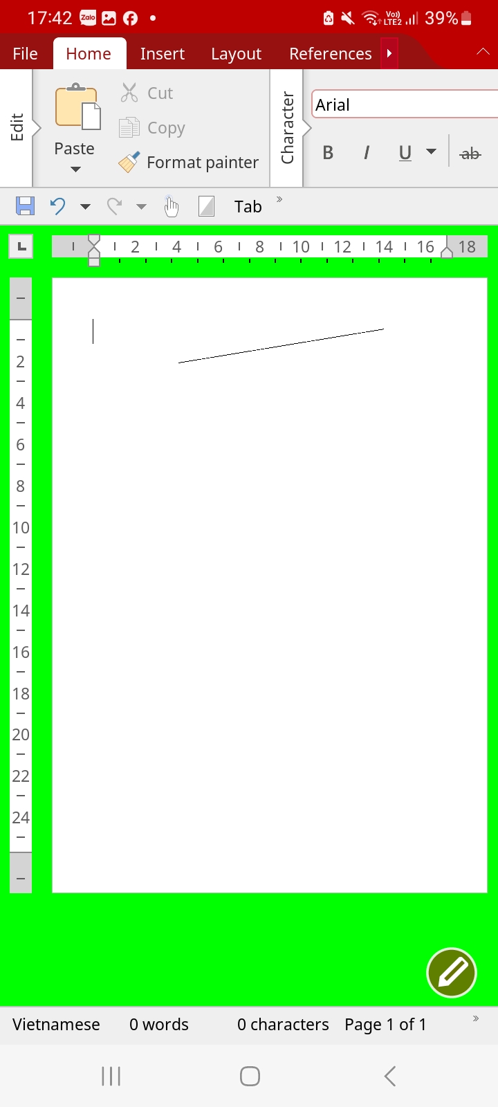

Usually, when drawing a straight line, it can sometimes appear broken or jagged. This doesn’t very nice. To solve this problem, I have a solution that’s a legitimate and safe ‘hack’:
1. Go to the ‘Insert’ tab and select ‘Line’
2. Select the type of line you want
3. Draw a tiny, minuscule line on the page – as small as possible and very short
4. Right-click to open the context menu. Then select the last option in the menu. Go to the ‘Format’ tab. Set ‘Height’ to 0; set ‘Width’ to 0. If you want to draw a straight line, you must keep ‘Height’ at 0. Simply adjust ‘Width’ to the desired length. If you do not want to draw a straight line but a slanted one, simply set ‘Height’ to 0 and ‘Width’ to 0. Then re-enter the values for ‘Height’ and ‘Width’ with the numbers you require.
Tip: Draw a straight line without it becoming broken or jagged
