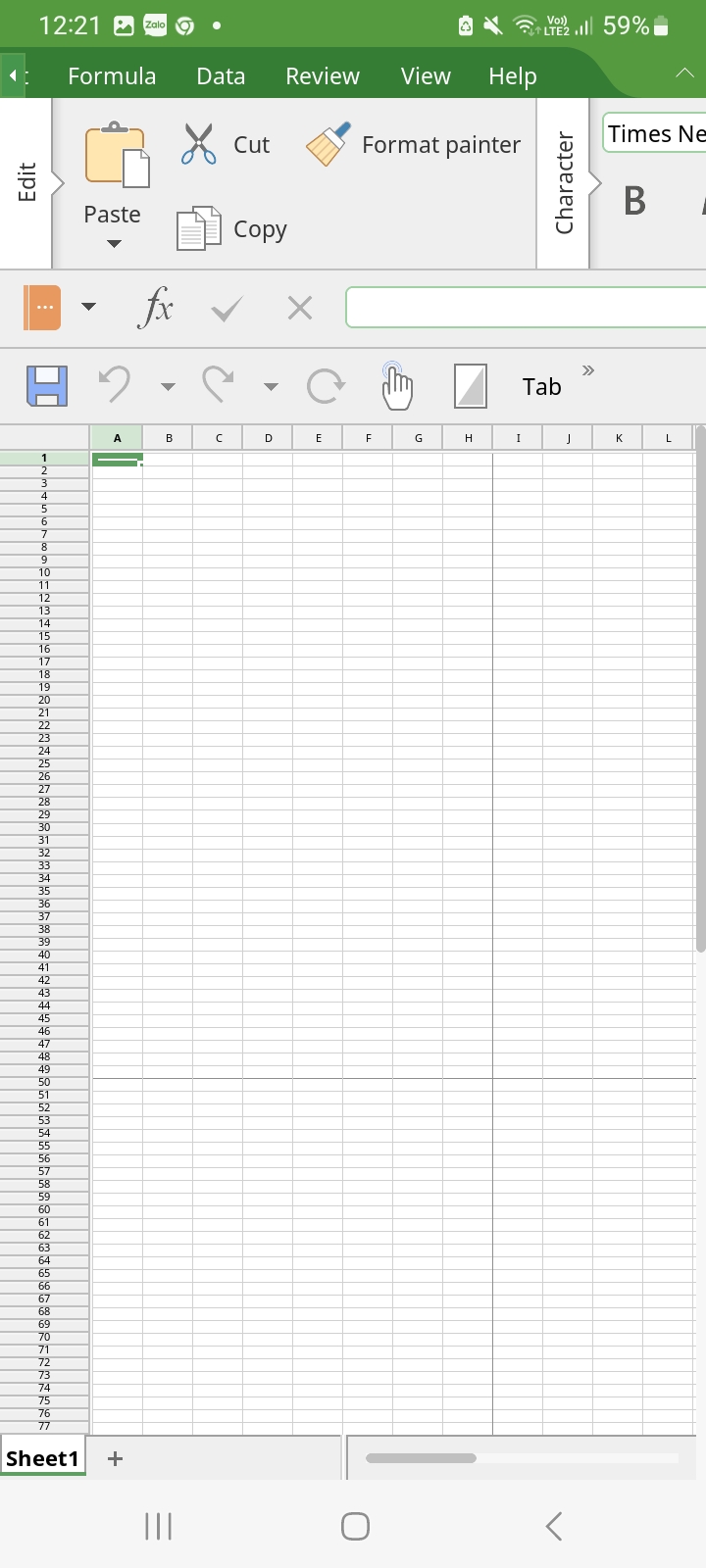

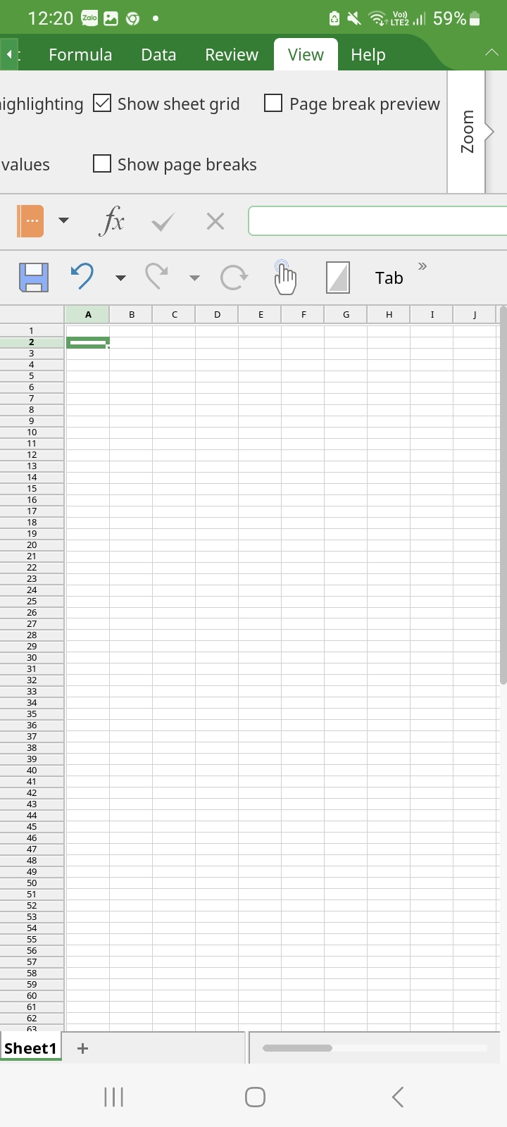

I found a small bug: When I unchecked the "Show page breaks" in the View tab. Then the horizontal line and the vertical line disappeared. But when you go to the File tab, select New, a new spreadsheet appears, but horizontal and vertical lines appear, and the "show page breaks" option pops up again. I also don't know how to make this option permanently disabled. Hope to fix this error.

Specifically, I use the galaxy A04s product of the android version 13

Re: Planmaker is error
This is a document option and not a global setting. You cannot uncheck it generally for all documents.
But you can save the "Normal.pmvx" template with this option unchecked, then all new documents based on "Normal.pmvx" (this is the default template when you open PlanMaker) will open with this option unchecked.
