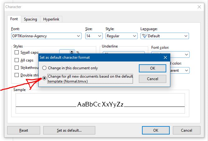

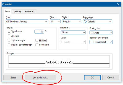

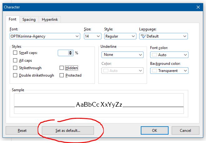

Hi,
when I follow the instructions from the site:
https://www.freeoffice.com/en/support/t ... /textmaker
"If you would prefer to start your documents in a different font to Times New Roman 10 pt, you can easily change it. Simply right-click in the document window to open the context menu and select the menu entry Character. In the dialog box "Character", you can now select your preferred font settings and make them your new default settings by clicking on the Set as default button. In the following dialog box, select Change for all new documents based on the default template. All future documents based on the default template will now use the selected font settings."
Even so, when I create a new document, Times New Roman is still pre-selected as the font. What could be the reason for this? Please don't say it's my stupidity ;-) Any help is welcome.
