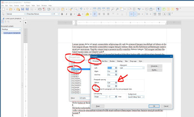

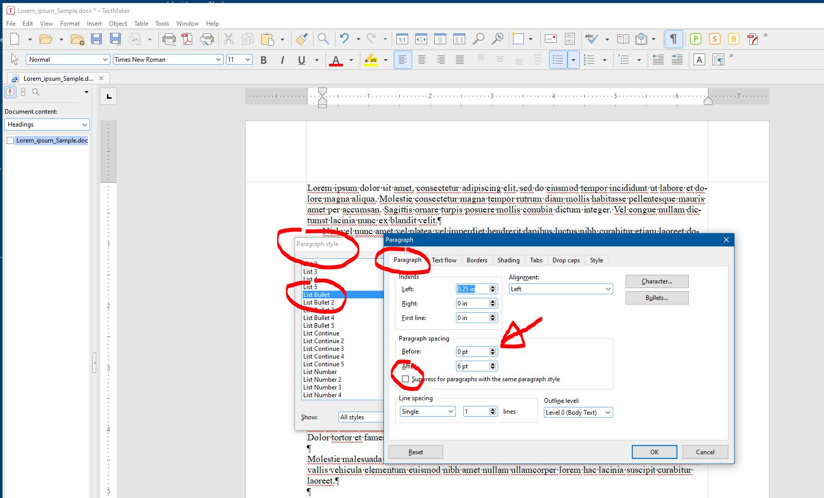

Posts: 931
Re: Line spacing in bullets
Go to the Format > Paragraph dialogue. Scroll down the list of paragraph style until you find "List bullet." Make changes until you get what you want.
