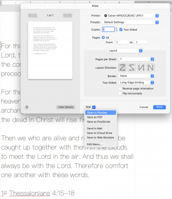

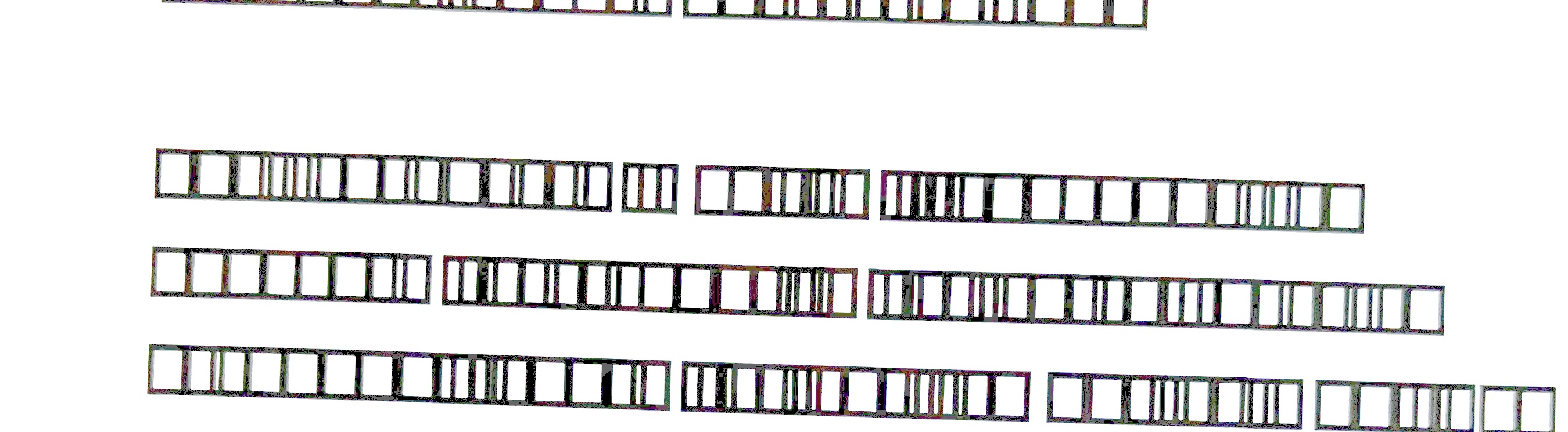

This morning I attempted to print 1st Thess 4 15-18 with TextMaker 2021. (See attached document)
Unfortunately, the verses would not print with TextMaker. They print perfectly with Word 2016 for Mac.
If I try printing with the Apple Printing system I receive useless symbols. (See Attached)
If I try printing with the Cups driver, I hear a beep and nothing ever prints.

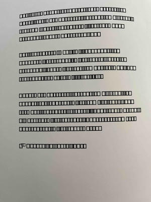

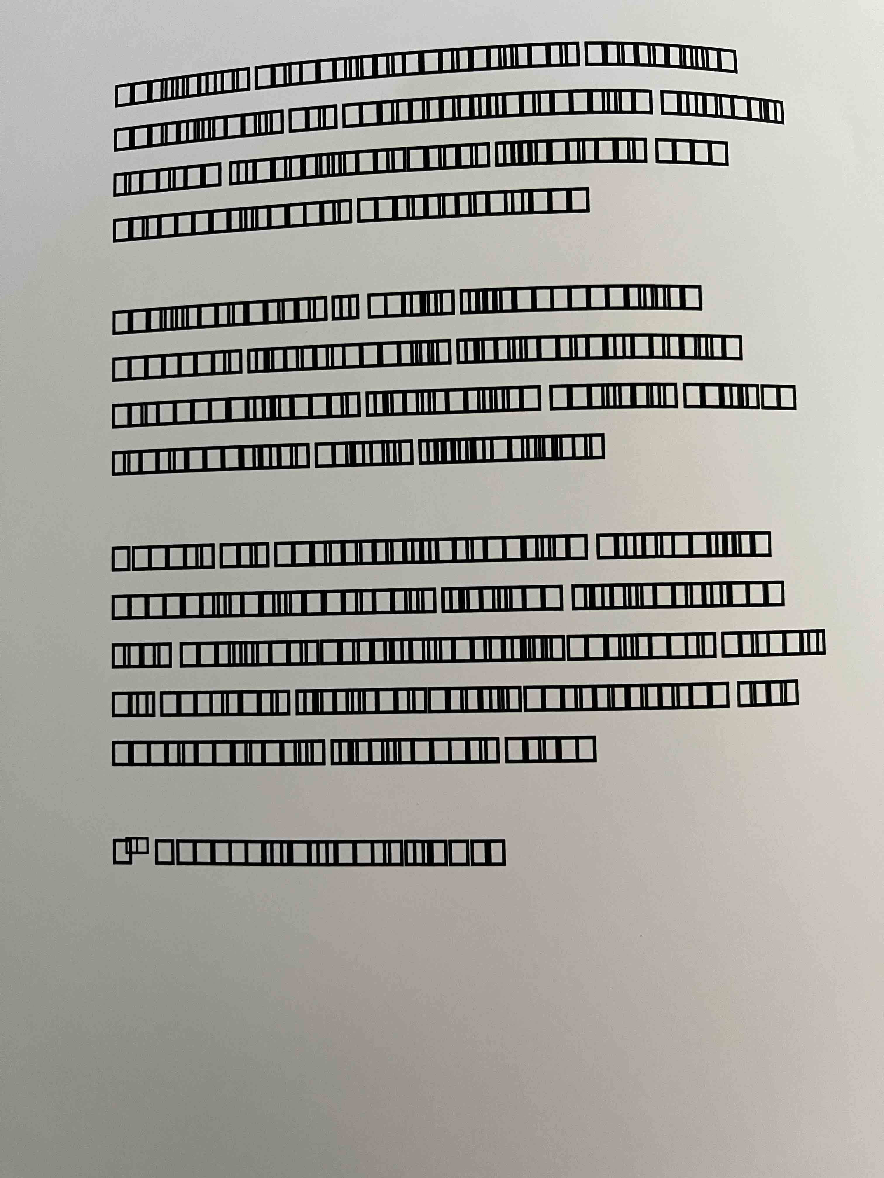

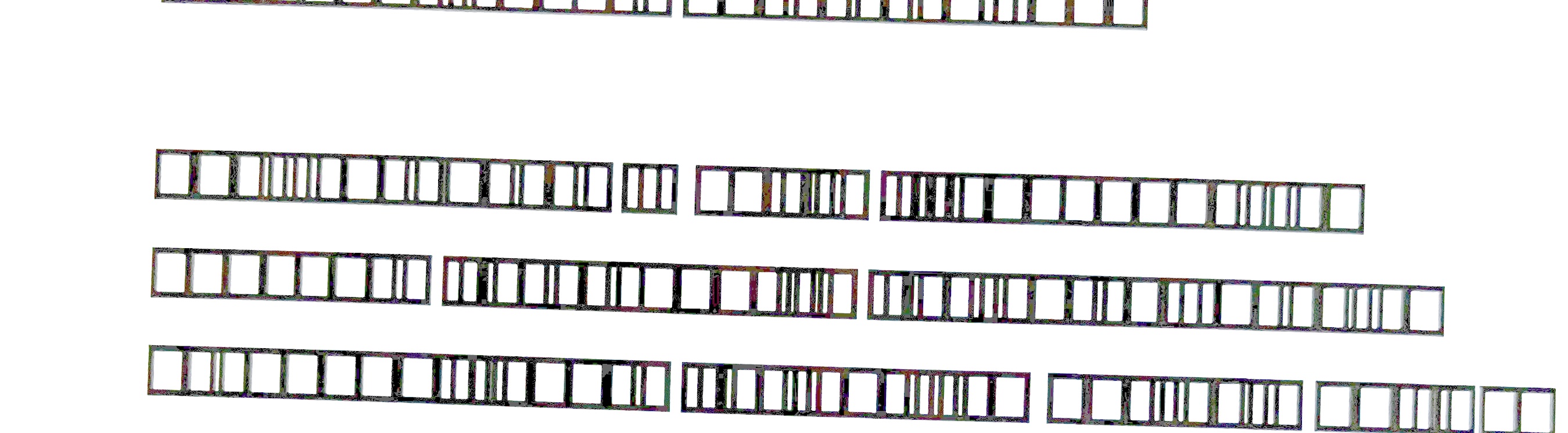

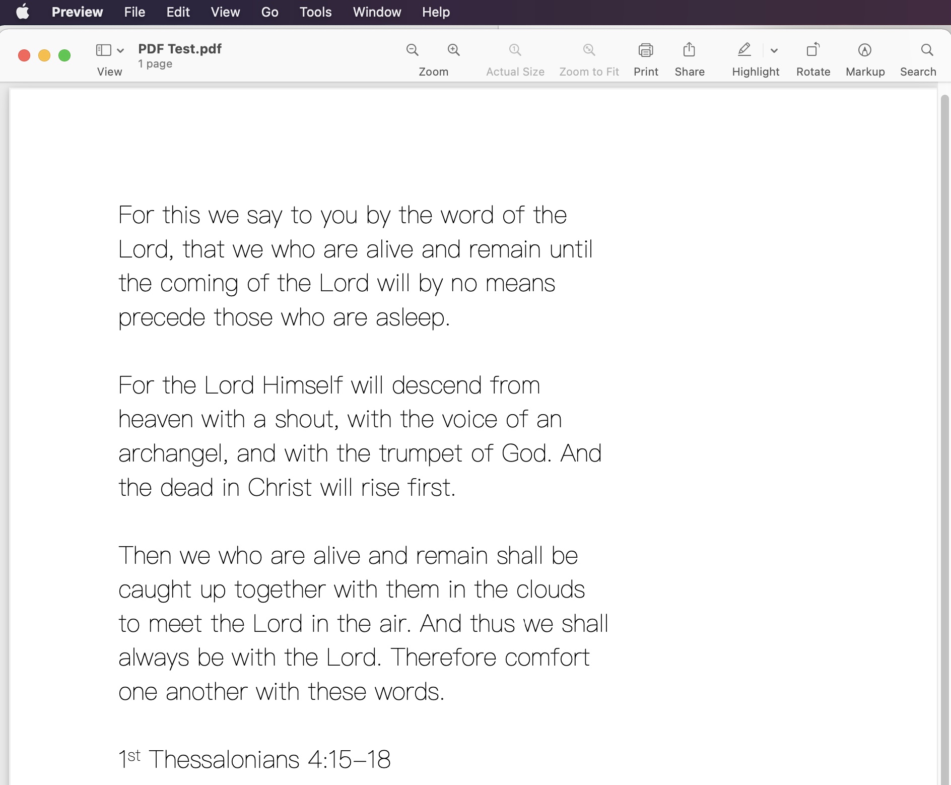

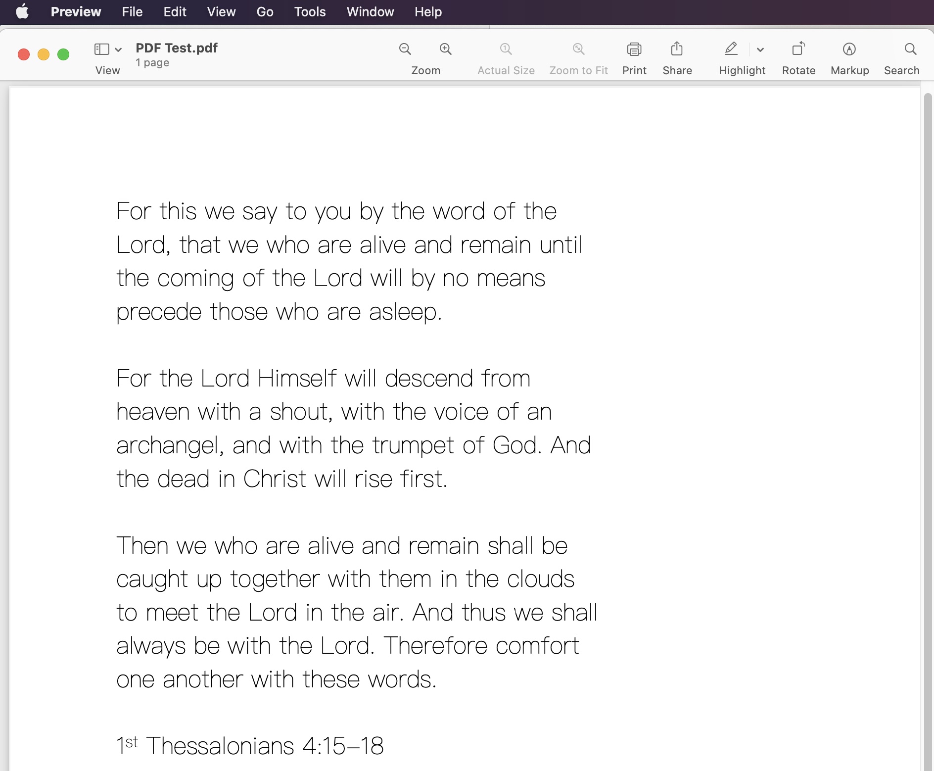

I have created a PDF document in three different ways.
1st Method:
File, Export as PDF.
Using this method the PDF looks normal in Preview (Built in Mac PDF viewer). However, the PDF does not print correctly.
Print Results:
2nd Method:
File, Print, Apple Print Dialog System, Print, Open in Preview
Looks normal in Mac Preview. Unfortunately, the same printing results as above.
Third Method:
File, Print, Print to File, open PDF in Mac Preview, File Print

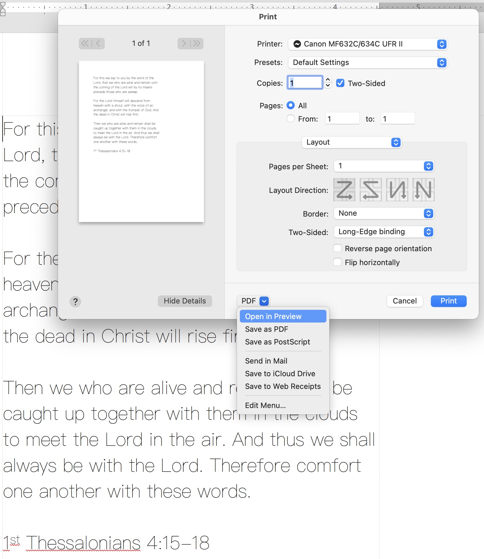

Microsoft Word 2016 prints this file correctly. Preview also prints this file correctly if I create a PDF from Word. (File, Print, Apple Print Dialog System, Print, Open in Preview)

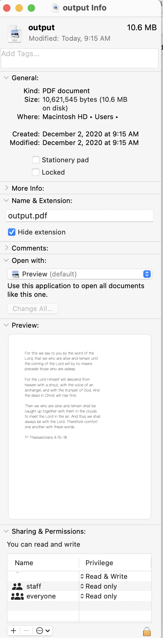

File Too Large Error
I attempted to upload the file created with the following procedure:
File, Print, Print to file.
Unfortunately, the file is too large to be attached to this forum.
Re: Mac Printing issues
Please send that PDF file created with third method to our email ID forum[at]softmaker.de
