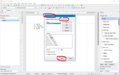

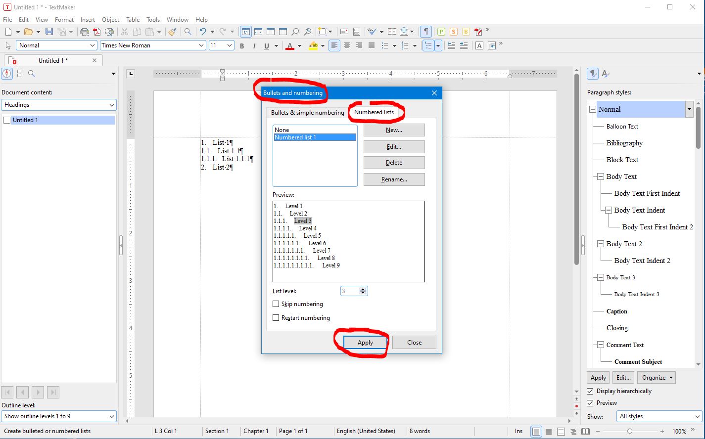

Please select numbered list instead of numbering which is just beside to each other and don't put anything manually which interrupt the automated process of numbered list.

Dissregard the fact that I use the classic menu system. The dialoge box should be the same.
