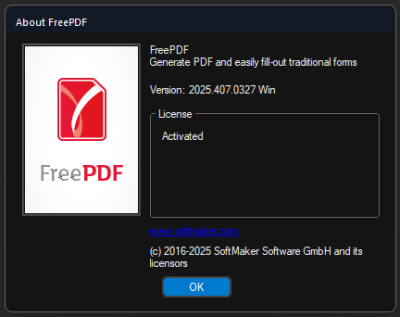

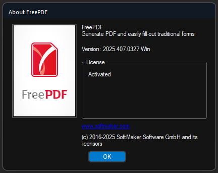

Please send a screenshot of "? > About" and a video demonstrating the crashes. There are plenty of free screen recorders you can get from the Microsoft App Store.

I have attached the requested plus the test PDF I was trying to open.
- PDF_TestPage.pdf
- (66.25 KiB) Downloaded 4804 times
- FreePDF_2025-11-16_22-45-55.mp4
- (266.96 KiB) Downloaded 4743 times

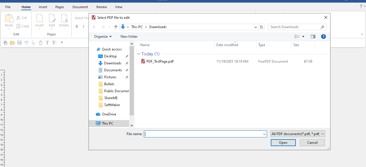

It very well could be, but I have no idea where to start. Are there any crash logs I could look at? No errors pop up or anything - the app just closes. Event viewer only shows the following:
