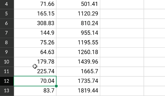

This probably is not specific to the Linux edition, but in Google or Zoho Sheets there is a super intuitive way of manually re-ordering rows (and columns). I've attached a screen capture to show what I mean, but basically you select one or more rows (or columns), then can drag and drop them. My question: is there an equivalent in PlanMaker ... or, if not, could this be considered for a future version?

It's not quite the same, though, precisely because, as you say, it overwrites any existing data that is there.
If it adds some context, one of the things I do with a spreadsheet is use it as a grid to layout information (vs performing calculations). Think of a to do list, for example. I might want to re-order my to do items, based on my current priorities. Dragging rows (or columns) to re-order them is therefore easiest *without* overwriting ... otherwise I need to do extra work to insert new rows, etc.
