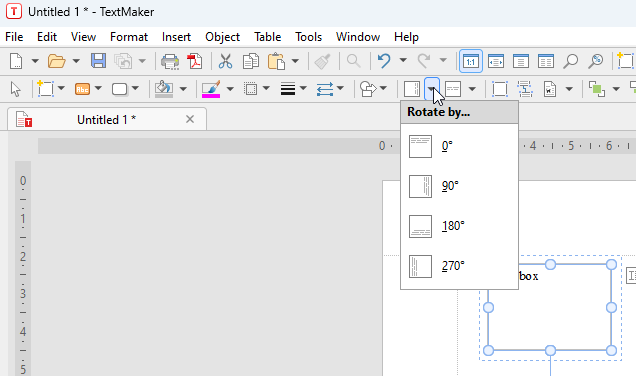

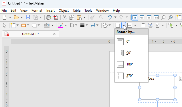

There is also another (shorter) way to find the "Rotate by" command in the classic menu: Use the Autoshape toolbar.

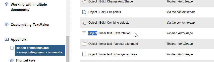

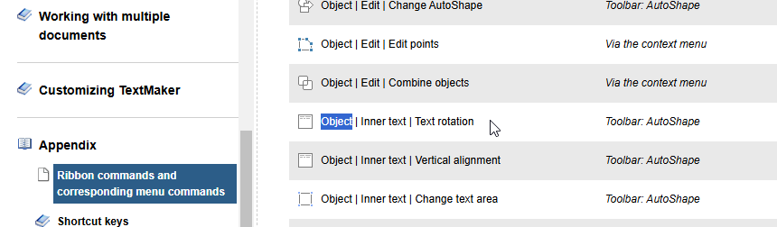

laffin_boy wrote: Tue Dec 03, 2024 11:09 pm Because the interface change clearly changes the way the program works SMO really needs 2 separate help files / manuals - one for Ribbon followers and one for Classic menu users.
A little help to find a corresponding classic menu command:
Look into the table of commands (ribbon -> classic menu) in the Appendix at the end of the manual.
