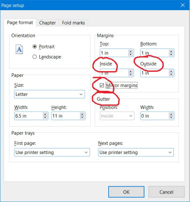

Hi, Iḿ ussing TextMaker and I need to configure the margins with up 5cm, 4 left, rigth and botton 3cm in the left page, and 3.5cm up, 4cm rigth, 3cm rigth and botton in rigth page, but TextMaker I see onlyone option. How I may to configure the rigth side? Thanks

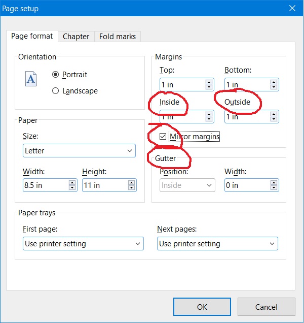

Thank you for posting your query. You can enable Mirror margins in page layout settings as described in our user manual.

Be aware that when you enable Mirror Margins, the side margin settings change from "Left" and "Right" to "Inside" and "Outside." The easy way to keep track of your margins is to set the inside and outside margins to the same dimension, and then use the "Gutter" setting to add space to the inside margin for binding.
