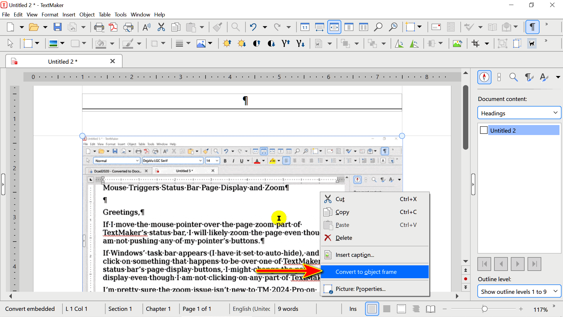

When I inserted the picture from a file, I used the Object → New Picture command, which I accessed from the classic menu system (no buttons were involved). When I right-click on the picture (see the attached screen capture), I am given the opportunity to “Convert (it) to (an) Object Frame,” which suggests that the picture is an (embedded) picture and not an object frame. When I paste a picture as a “DIB picture,” I am given the same option to convert it to an object frame, suggesting that the pasted picture is also an embedded picture.
a. It would seem, therefore, that the default picture object settings are being applied to pictures imported/embedded via “New Pictures,” but not those imported/embedded as pasted pictures even though both picture insertions result in an embedded picture.
b. There is an ability to “Set as Default” changes made to pictures that were pasted, however changes made and saved as defaults don’t actually change how future pasted pictures are handled.
