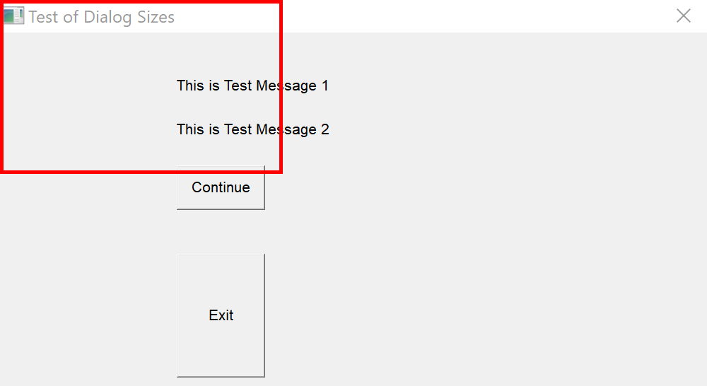

I have just started using BasicMaker and, almost immediately, I have found a problem that I cannot fix and I am hoping someone can set me straight.
First, let me provide a couple of statements from the manual: The definitions:
Begin Dialog DialogName [X, Y,] Width, Height,
Next, the definition of these values:
X, Y Optional. Sets the screen coordinates for the upper left corner of the dialog box (in screen pixels).
Width, Height Sets the width and height of the dialog (in screen pixels).
Next, a short program illustrating my problem:
Code: Select all
Sub Main
Dim pm as Object
Set pm = CreateObject("PlanMaker.Application")
Begin Dialog Welcome 500, 500, 400, 200, "Test of Dialog Sizes"
	Text 100, 25, 150, 45, "This is Test Message 1"
	Text 100, 50, 150, 75, "This is Test Message 2"
	PushButton 100, 75, 50, 25, "Continue"
	PushButton 100, 125, 50, 70, "Exit"
End Dialog
Dim WelcomeDialog As Welcome
DialogReturn% = Dialog(WelcomeDialog)
End Sub
Then, finally the dialog box that the BasicMaker program drew:Image
The first thing to notice is the red box - The program calls for a dialog box 400x200px; BM drew one that is 1000x500px! From the picture, it is easy to see that the locations of the texts are wrong as are the locations and sizes of the buttons!
I hope someone can point out to me where I am going wrong. Thanks in advance.

Re: Dialog Box Sizes and Locations Incorrect
I was able to reproduce the issue:
The XY coordinates are correct, but the width and height are more than doubled.
I reported it to the developers.
Reply from the developers:
For dialog width and height, we use "dialog units"
These dialog units are then converted to pixels depending on the currently used dialog font (that way text should always fit, regardless of the dialog font you use, because it adapts to the font).
We will correct the manual to mention that (X,Y) is display pixels and (W,H) is dialog units.
We updated the web manual and the PDF manual will be updated on the next service pack for version 2024.
