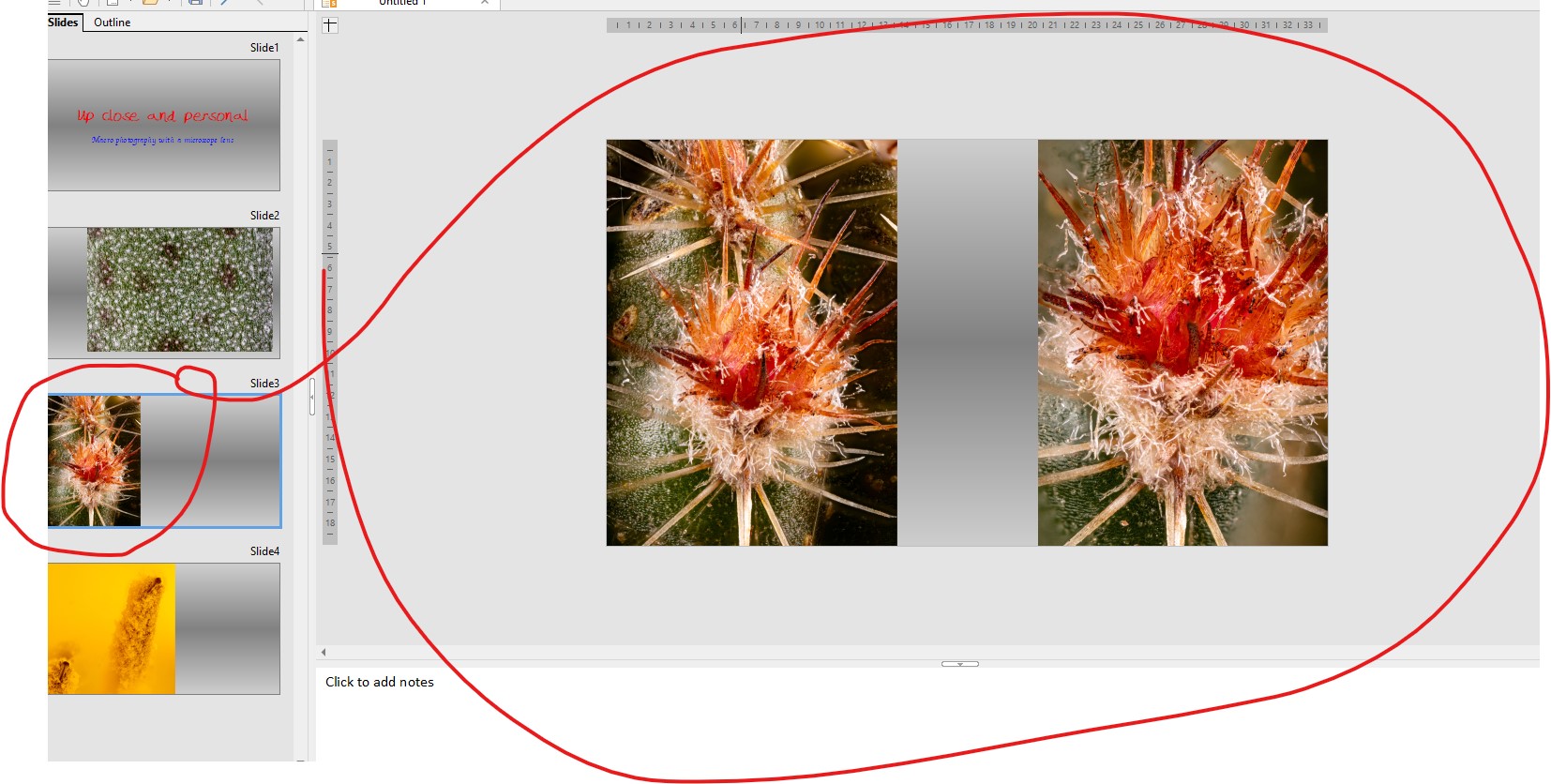

Insert> Picture onto blank slide
repeat with new picture
Two pictures appear on the slide but not the thumbnail

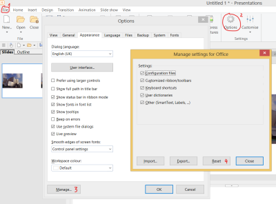

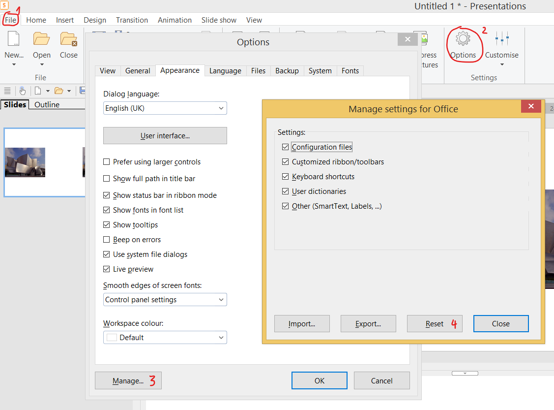

Unfortunately, I can't reproduce the problem reported. To resolve the problem, you could try to reset the settings of SoftMaker Office. See the screenshot.
