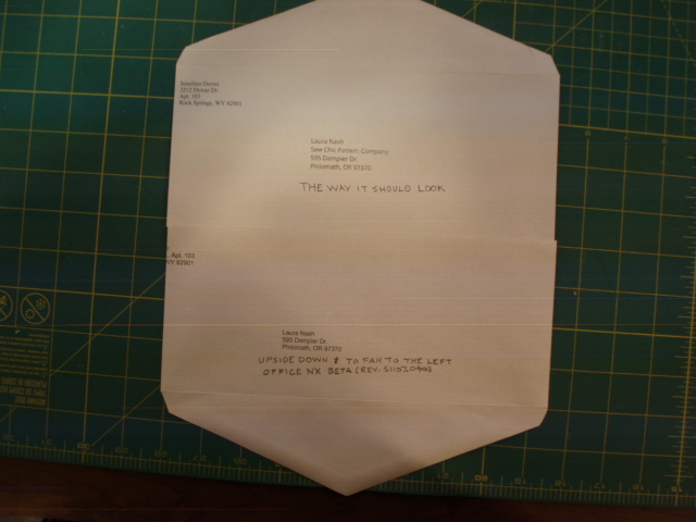

Below is a picture of the correct rendering (top) made from my own template in Textmaker 2021 and below is the defective envelope made in Textmaker NX 2024.

The top envelope is printed correctly. It is made from a user created file.

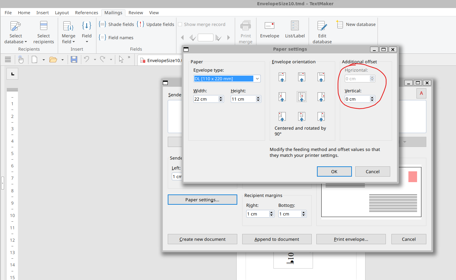

Did you check the offset values in Paper settings...? Are these settings the same as in your version used previously?
See the screenshot.

I did try the offsets and they had no effect. Also note that the generated envelope is upside down.

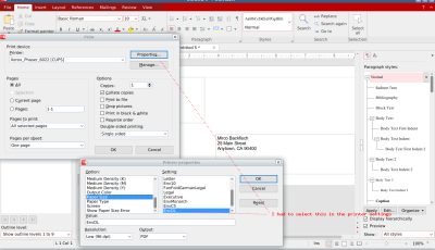

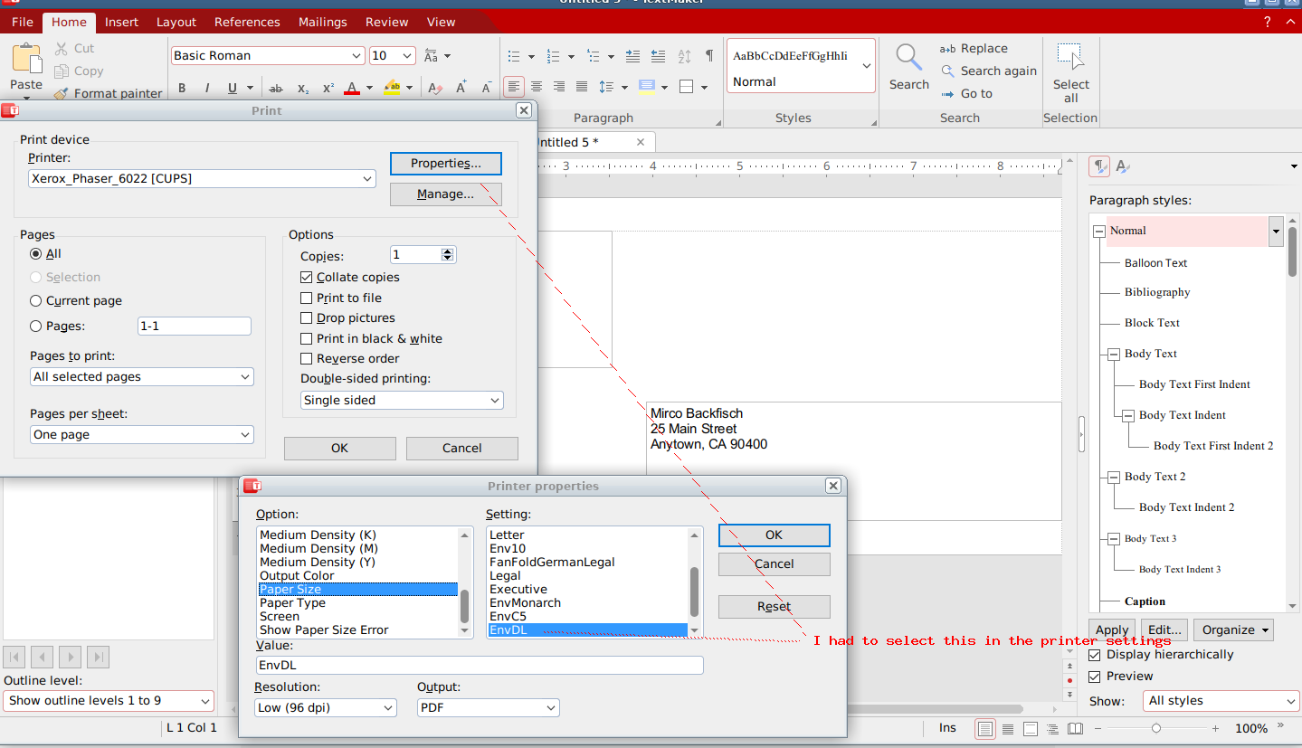

>> FIXED << This is solved
When I printed the first envelopes I failed to also select the printer paper size as sown in the photo below:

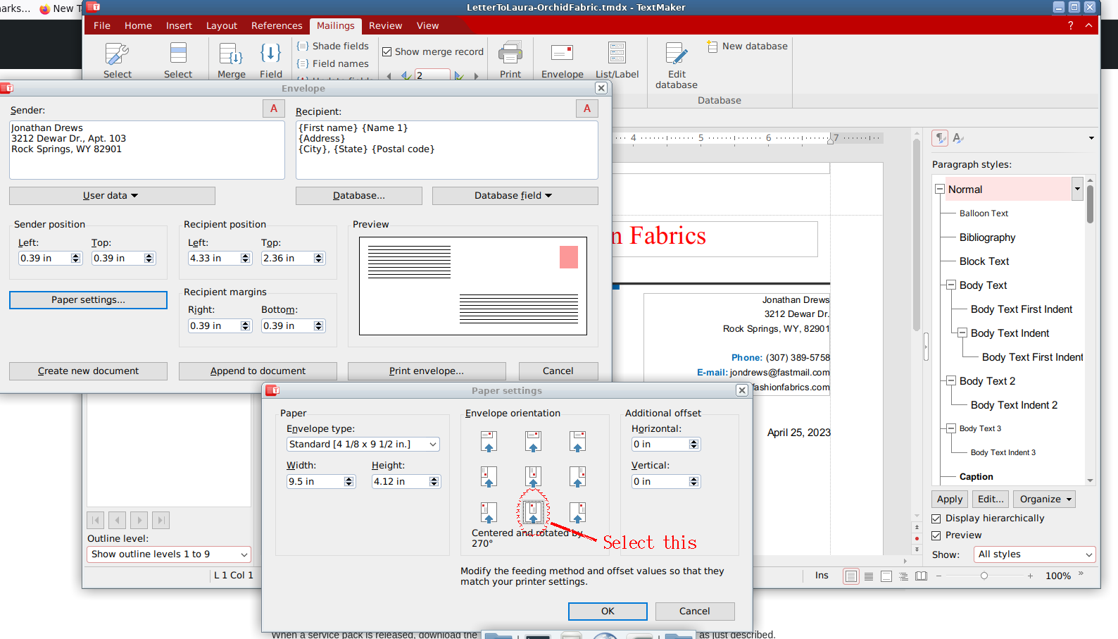

Post by cleetus »
It was also necessary to choose a different orientation for the envelopes.

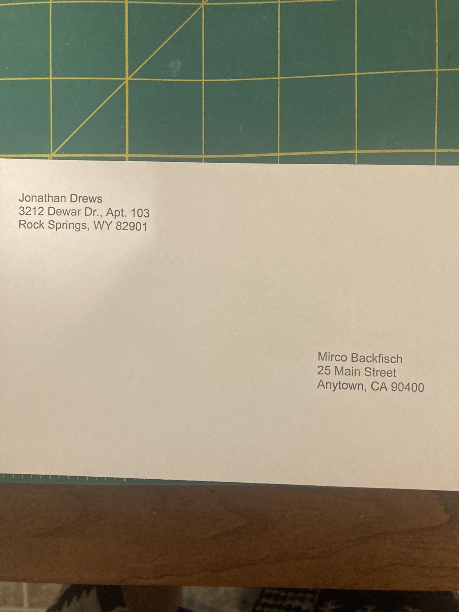

Post by cleetus »
Here is the printed envelope:
