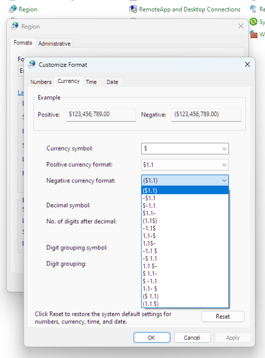

Thanks for your post. This is happening because for certain customization that last extra space is required.e.g. to represent negative currency in (123.45) format.
You can either use custom currency format as you already used or please change this negative currency format from ($1.1) to -$1.1 etc.
To do that, please open control panel > Region > Additional settings > Currency. Please refer to the below screenshot:
