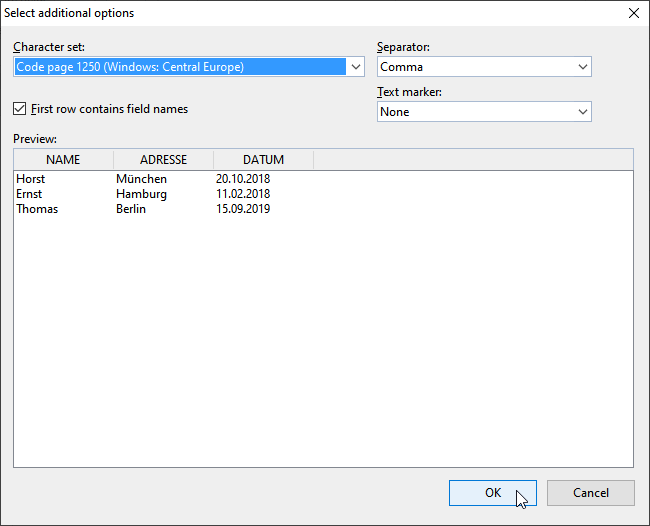

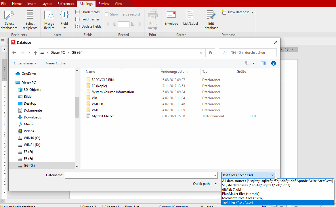

The correct description is: choosing the command "Edit database", first opens the file browser (and not the dialog box). In the file browser you have to select your text file (step1).
Step2: After selecting and opening the text file (via the file browser, that was opened with the "Edit database" command), a dialog box opens. In many cases, you dont have to adjust anything here, because TextMaker automatically detects the structure of the text file. In some cases, however, you have to customize the separator (comma, semicolon,...) or the character set (Unicode, UTF,...) or if the first row contains field names. This customization can help to display the data correctly, but in most cases it is not necessary.

Step1: Choosing the command "Edit database" will open the file browser. Select here the text file to import it as a database.

Step 2: A dialog box appears. If the structure of your data is not displayed correctly, adjust these options. If everything is correct, press ok.
- Dialog box with options.png (8 KiB) Viewed 41392 times
