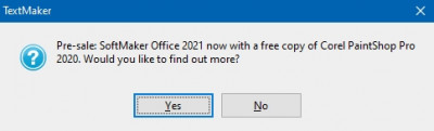

Ok, I deleted the file and started Textmaker and this is what I got. A little bit different from the last one.
- Posts: 3189
- Location: Nürnberg, Germany
- Contact:
Re: Weird Pop-Up Message
This is the current message we are sending. Can you now exit and restart TextMaker? Does it appear again?
