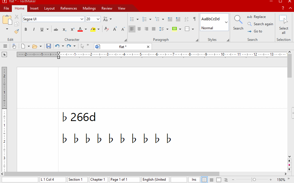

See attached files including the animation.
To insert the flat symbol:
1. change the font to Segoe UI
2. Type 266d and press ctrl+alt+shift+x
After that, you may select the symbol, copy it and paste it into the search box
- flat.docx
- (11.89 KiB) Downloaded 5382 times
Re: Musical flat symbol
Miguel, thanks for your very prompt reply.
After more head scratching, I was able to follow the simple steps you set out, and I finally got a 'flat' symbol on a document.
For dunderheads like me, the key seems to be that before attempting any shortcut, a correct font must be selected, namely a 'UI' font.
Before my first post, I had read the TM2018 manual on this subject, and if I might offer an observation, page 147 might in a future rewrite be clarified. The highlighted note states the fact that 'the font' is not remembered. It might usefully add that for any of the keyboard shortcuts to work properly, a UI font must be selected. That thought might also be added into the paragraphs below on the same page, dealing with other forms of insertion shortcut.
Yours very gratefully, KeithM
