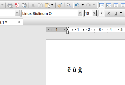

mgrinsven wrote: Fri Feb 21, 2020 9:57 am What am i doing wrong in Textmaker? Somehow dead keys are not working. I run Textmaker in the Dutch language on Ubuntu 18.04. Everywhere else dead keys are working (i.e. ë by pressing " +e).
Good evening.
While I do not believe that you are doing anything wrong, the problem does however not concern everybody. I can compose arbitrary accented characters or add diaeresis to arbitrary characters, even in TextMaker.
Although I am using Debian and not Ubuntu, the divergence between TextMaker and the other components is surprising. Have you verified that you use the *same* font, when you compare TextMaker to PlanMaker and Presentations? But that is just a wild speculation, only SoftMaker can give you a real advice, here.

joredor
Posts: 53
Joined: Thu May 25, 2017 1:50 am
Re: Dead key support
Post by joredor »
Huh, this doesn't work for me. When I type ^ and then o, I simply get ^o. XIM is indeed enabled (Tools --> Options --> Use XIM).
Tried this on TM for Linux version 974 a few minutes ago, and then again on 976 after installing the new service pack. I'm on Kubuntu 18.04 LTS.
