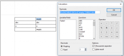

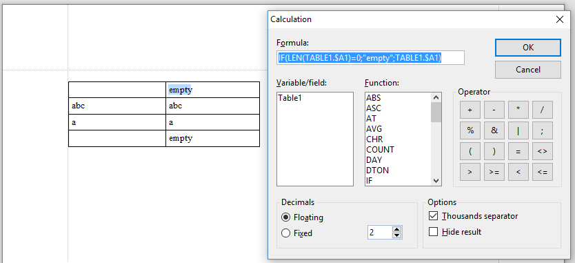

raitis.veksejs
- Posts: 208
Re: Conditional text fields
Here will be sample file and screenshot of how it could be achieved.
- Sample.tmdx
- (8.26 KiB) Downloaded 6659 times

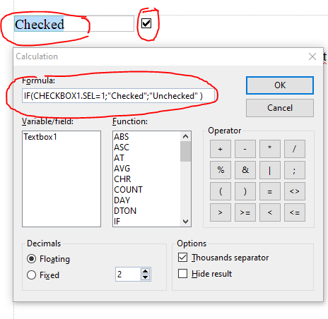

Hi!
Revisiting this question - is it possible to do something similar with textboxes in forms? What I want to do is display some text in a box if a textbox somewhere else in my form is checked.
Yes, it can be done with the following formula:
IF(CHECKBOX1.SEL=1;"Checked";"Unchecked" ) To update the formula you may:
Press F9 or type anything on the document. It also updates before printing or PDF Export and also when opening the document.
- checkb.tmdx
- (12.7 KiB) Downloaded 6637 times
