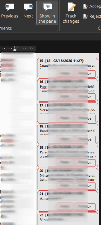

On beta 7, working on the same file that has 500+ in 37 pages.
This should not happen. I think part of the issue is the buttons. What if, the buttons hide of all comment boxes and only are shown on the selected comment?

As shown in your screenshot, the comment you select pops out, allowing you to read and reply to it. Please let us know what difficulties you are experiencing with this functionality.
It may look visually confusing, but it behaves correctly. We are currently working on reducing the visual confusion.

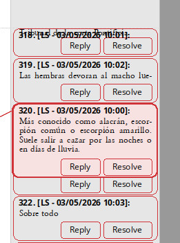

Notice the rendering on the first comment (318) where the text overlaps. This should not happen.
Re: Coments
Thank you for the screenshot—it does look incorrect on your end.
However, we were unable to reproduce the issue in the latest beta using the two files you previously sent (comment-slowdown.tmdx and Example.odt), on both Windows and Linux versions of TextMaker.
