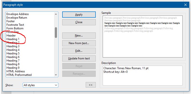

TextMaker does not have a pre-made style for ""Headline," but they do have a pre-set style for Header, and in the style menu 'Header" appears immediately above "Heading1." Is it possible that you wanted to click "Heading1" and you clicked "Header" by mistake?

I am confused. The posts describing this issue appear to be conflating "Header" style with "Heading#" styles.
I have TextMaker 2026. I have just one pre-set style for "header." I have pre-set styles for Heading1, Heading2, Heading3, ... Heading9.
There is no style named h1, h2, h3 ...
Does this occur when changing the "Header" style, or when changing the level of the "Headings"?
