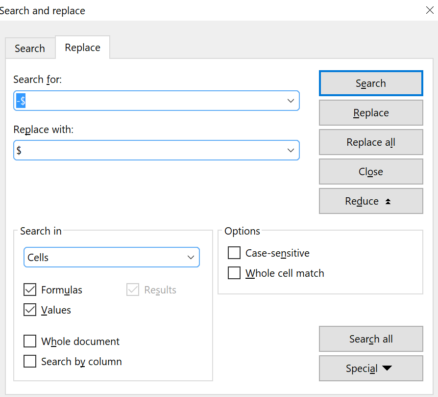

I found the fix that worked for me. I too imported from my card charge company. the fees were all negative and would not sum. The only way I found to convert them all to positive at the same time was using the search and replace command.
Under search,
type "-$",
click search all,
click replace tab,
type "$",
click replace all.
