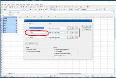

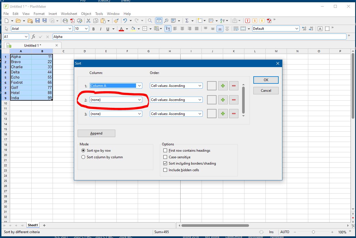

This kind of sorting error is usually caused by not selecting all the columns involved in the data set you want to sort. In PlanMaker, simply highlighting two (or more) columns doesn't ensure that both will be sorted together. When you tell it to sort, verify in the dialogue box that both columns are designated to be sorted.
