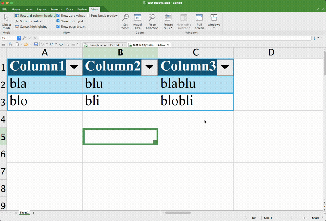

@SuperTech's comment referred to these methods not working:
a) Click the last cell of the table and press Tab.
b) Right-click the last row and select "Insert row below."
c) Hover over the bottom-right corner of the table until a line with two arrows appears, then click and drag to expand the table.
but there is one method of inserting new rows that will work:
d) Click the bottom-right cell, hover over the bottom-right corner until a white plus icon appears, then click, drag, and release to add new rows.
A video demonstrating the working method is attached.
Implementing a-c so they transfer formulas is on the wishlist.
Re: Formula don't propagate to new rows in Table
Hello raitis.veksejs,
Thank you for your reply.
Unfortunately, method (d) only propagate formula from the cell you drag, not all formulas in the row.
Tested with the last release on Windows 10 : PlanMaker NX Home (rev S1230.1206) 64bit
