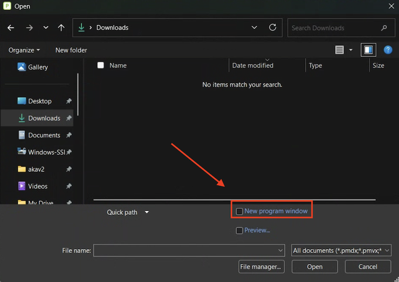

For users who need this in the future:
Select "File > New" or "File > Open," and in the file dialog that appears, check or uncheck the option "New program window." Once set, this option will remain active for future sessions.
