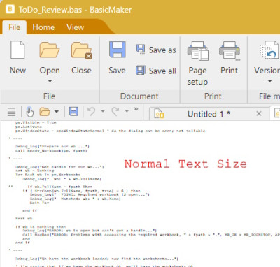

I've just opened BasicMaker to try and deal with some code... and for some reason, the font size in the editor has become minuscule, viz:-

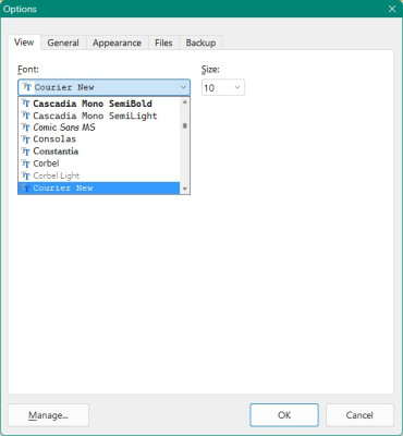

The File > View > Customize settings haven't been changed, viz:-
Changing the font values doesn't alter the way the editor looks.

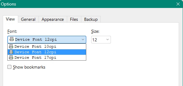

Select a functioning printer driver in File | Print. The "Generic / Text only" driver is unusable.

martin-k wrote: Sat Jul 12, 2025 3:32 pm Select a functioning printer driver in File | Print. The "Generic / Text only" driver is unusable.
Pretty weird design 'feature' that a Printer setting should affect the User Interface... although, those limited available fonts were definitely a clue.

File > Options > View > Manage > Reset
...all settings.. default values... : YES
...restart BasicMaker... : YES
...User Interface settings (as required) : OK
File > Options > View:
...and the editor looks Ok... but 'tis still curious how it changed... Maybe it WAS as simple as changing the printer somewhere else updated the 'system default' (I guess).
