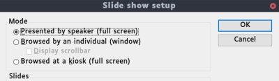

Hi,
I am having an issue with the presenter view. My computer has two displays (the laptop's and a connected monitor) which are recognized by Presentation. I think I have configured presenter view correctly (see attached screenshots) but when I start the slide show, only the slideshow starts, without presenter view. It used to work perfectly before the upgrade to NX.
I tried restarting Presentation, re-plugging the external screen. Note that I tried on another screen and it worked. But on my own screen in my office, it consistently fails.
Can you help me with this?
Thanks!
[EDIT] I can't believe I didn't test this before, but the presenter view activates properly if the Presentation window is on my laptop screen when I start the presentation. If the window is on the connected screen (though the external screen is configured as my primary display) then the presentation view does not start.
Screenshot of the display configuration
Screenshot from 2023-08-22 11-02-00.png (6.71 KiB) Viewed 81282 times
Screenshot of the slide show setup

Thanks for your post, but we are unable to reproduce this problem. As you are also not facing this problem when you are using different screen, there might be some problem with your this screen settings/display driver etc.
Please check the settings, reinstall driver or get help from your IT support staff for this external screen problem.
You can also try manually selecting display instead of selecting Auto.
Please also make sure that you have checked the options "Presenter view" in the display settings.

I can confirm this is a thing. Some screens/beamers are recognized - some aren't. Operating System Linux Mint recognizes second screens always - however NX doesn't treat all screens/beamers the same way. Some are always working - some are never working. There is an issue with Presentation NX on that. I will try the workaround the previous poster described. But please Softmaker - do look into this as it is kind of annoying...

I have experienced this before and it has nothing to do with SM Presentations, but with the window manager itself. In some, like in Enlightenment, you must tell E that windows can be placed outside useful geometry, otherwise it wont work. I ignore what window manager/desktop are you using but is worth taking a look at it. This happens because SM Presentations is too polite and honours what the wm is telling it, while other programs, like LibreOffice Impress simply ignore what the wm is telling it to do.
Another workaround is moving manually the presentation to the other screen, usually (if not always) the Presenter view is bellow the presentation window.

I have forwarded the details related to second screen to our developer team.

This issue has been resolved in the latest service pack, version 1218.
