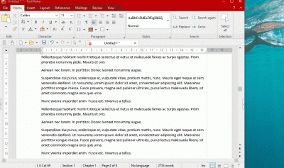

For the meantime I have another suggestion, even if it is not a shortcut:
You can use the buttons of the vertical scrollbar. Click on the red button and select "Page" on the top of the red buttons menu. Once selected, you can jump to the next/previous page with the up/down arrow buttons in the scrollbar.
It's a really fast way.
You can find this information more detailed in the Online help.

That would be really fast ... if it worked. I just tested it using TextMaker 2021 and it does not work as you described.stascheit wrote: Mon Jul 18, 2022 5:38 pm For the meantime I have another suggestion, even if it is not a shortcut:

Thanks very much, that is quite helpful! It does work for me, although those arrow buttons are extraordinarily small. Best of all, once the choice is made in the red-button menu, it persists from one TextMaker session to the next, so that the function is always available. I generally prefer keyboard shortcuts to mouse clicks, but this will certainly do.stascheit wrote: Mon Jul 18, 2022 5:38 pm For the meantime I have another suggestion, even if it is not a shortcut:
