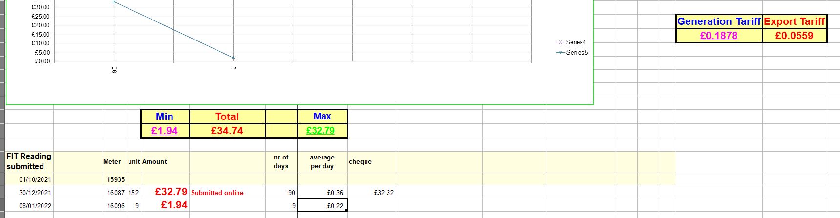

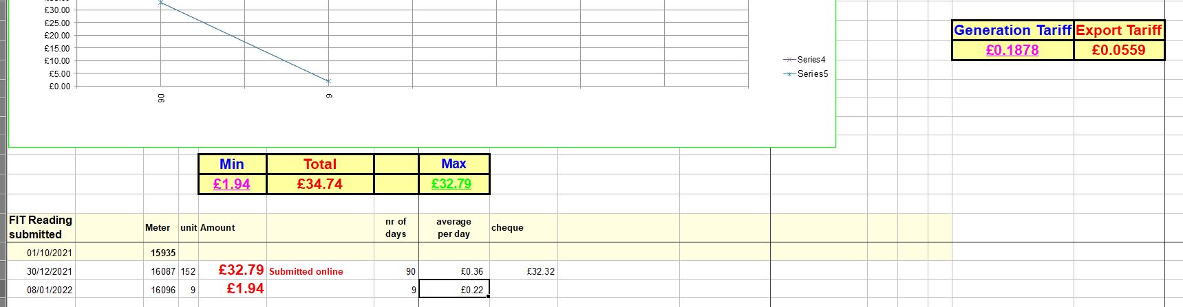

Re: how to reference a variable value (not the best of descriptions)
I have just added the formula so that you can get the latest tariff values in graph sheet as per your requirements. No other change.
Here are the values I am getting after adding your latest tariff values.
Do you want attachment also? I used the same file which I shared last time and just entered one new entry in tariff. No other change.
