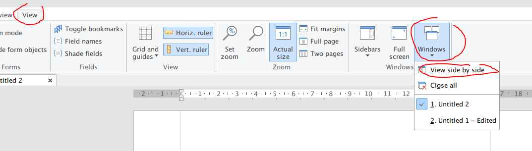

Re: Two TM displays, both visible side by side
He you go: Also, nobody at SoftMaker was able to reproduce the black screen, so it's probably a macOS beta issue that will go away in the final versionJohnWasilewski wrote: Tue Oct 05, 2021 5:41 pm Thanks Miguel-C.
Incidentally, you also wrote earlier,But when I pull down the 'View' menu, it does not show a 'Side by side' option, so what did you mean exactly, please?you can also go to View | Side by side.
John
