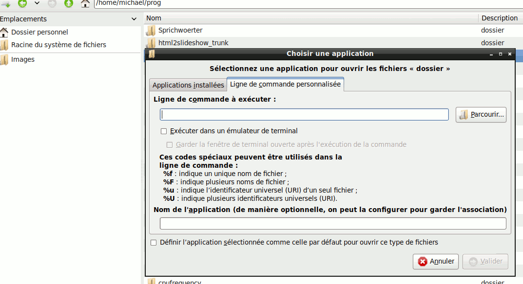

The file manager itself must be prepared for that. PCManFM, Thunar and probably others allow to add user-defined commands which will be available from the context-menu (right-click-menu) after a file of a certain type (mostly based on the filename-extension) or a directory are selected.
Here is a screen shot of the dialog (in French locale) serving to add commands to PCManFM, Thunar looks similar: If SoftMaker can assist, they will be able to do so for only one file manager at a time. But there are so many.
