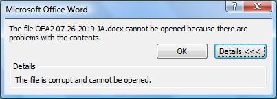

In a trial project for a full transition to Linux, I'm editing a book in TextMaker 2018 Professional for Linux.
Both my author and my publisher use MS Word, so I need to make sure that files that I edit in TM will work on Word. Therefore, before sending the edit back to the author for fixes, I move the book file to a Windows PC and open the file in Word as a test. Unfortunately, when I do that I am getting the following error message in Word (2007):

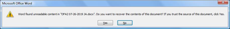

Although Word complains, if I tell it to proceed the document will open, although I get the following message...
...and the filename is lost (it displays as "Document 1"). However, after a spot-check all my changes appear to still be there (I haven't performed a full side-by-side comparison).
Is this a known issue, and what can I do about it? One workaround might be to remember to rename the file before sending it on, but this can get tedious and it's not clear that the file contents are in fact the same.

ADDITIONAL INFO: I tried to open in Word an earlier version of the document that was saved in TextMaker 2018 for Windows, and Word gave the same message about corruption in the contents. So it may not be strictly a Linux issue, but rather a TextMaker issue (?).
