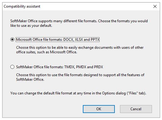

Where do I find the "Compatibility Assistant" touted in the Softmaker blog? I have been searching the TM 2018 menu's for the Compatibility Assistant, but no luck. With this assistant one can make quite sure that all of your files will by compatible with MS Office.

It's quite well hidden: File > Properties..., tab "View", button "Compatibility...".ecbritz wrote: Sat Jan 13, 2018 1:54 pmWhere do I find the "Compatibility Assistant" touted in the Softmaker blog? I have been searching the TM 2018 menu's for the Compatibility Assistant, but no luck. With this assistant one can make quite sure that all of your files will by compatible with MS Office.
Edit: Sorry, I misunderstood your question.
