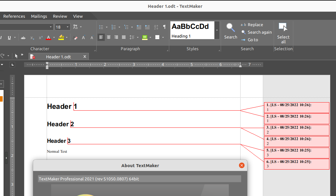

Thanks for sharing sample files, but I can see all comments in your ODT file also. Please check this below screenshot for your reference.
Please make sure you have updated your SoftMaker Office to the latest revision S1050. Please share your sminfo.txt file.

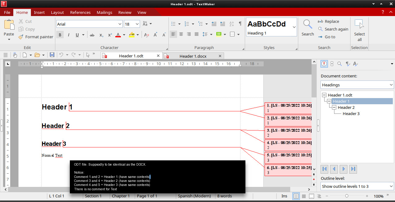

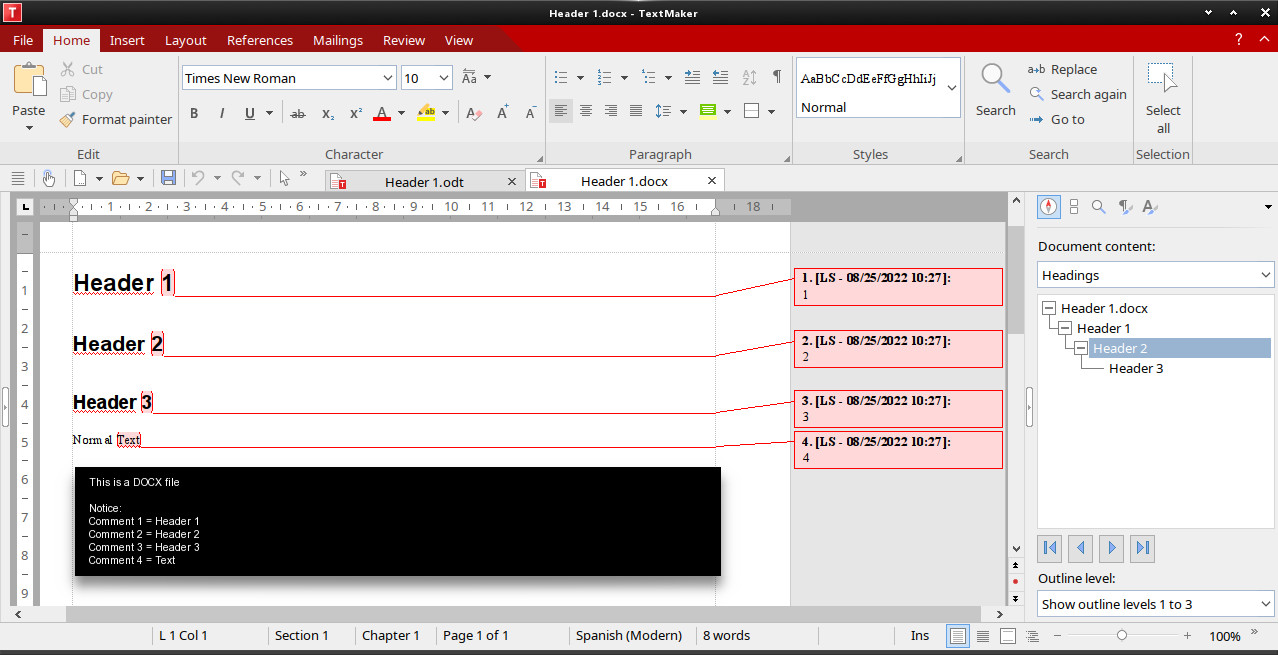

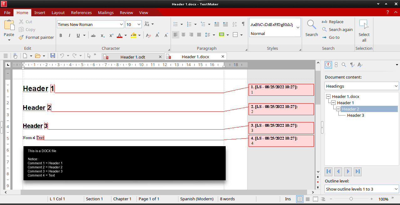

Your screenshot shows the problem right there. Please compare the odt file against the docx one. You'll notice that the last comment belongs to the paragraph (Text) and not a header. In the odt file is showing as if this comment was part of the header. Is not. Also notice that the text form comment #4 (the one that is in reality assigned to paragraph, but in the odt is show as assigned to header) has a different content in the docx file, while in the odt the comment is the same.
As I stated before I'm using rev S1050.0807. Please double check both files in a careful manner. Is evident you did not. If you did you would have notice the discrepancies after comparing both of them. You can alternatively take a look at the attached screenshots.
You can open the docx file and save it as odt, then open the newly saved file and come across this issue too.
ODT file. Comments show incorrectly
DOCX file. Comments show correctly
