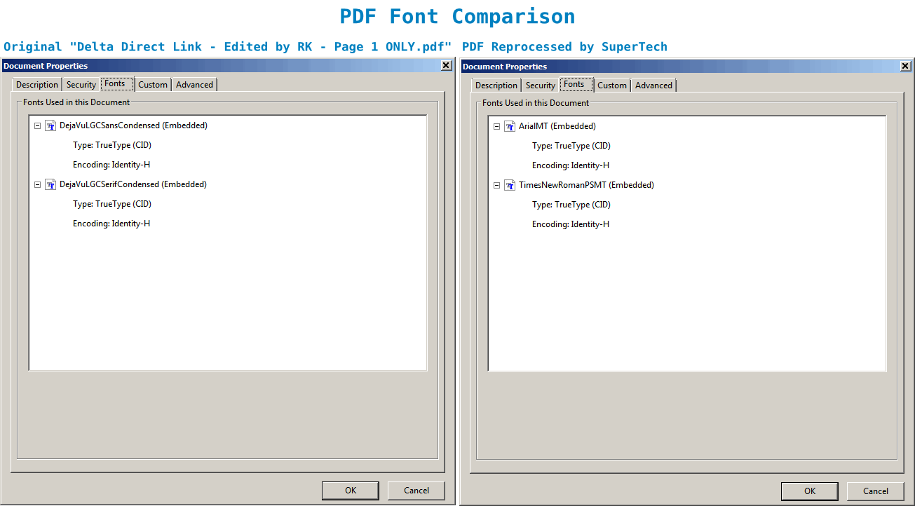

The TOC in your PDF is correctly formatted, however TextMaker, Windoze, or someone/something else made font substitutions such that the PDF you produced does not use the same fonts that I used. (Apparently you don’t have “Dejavu LGC Sans Condensed” and “DejaVu LGC Serif Condensed” [both version 2.37] installed on your computer.) So does the PDF show that there is a problem with the DejaVu fonts I use, or does it show that TextMaker produces improperly formatted TOCs depending upon what font, font sizes, font styles, etc. it encounters? Based upon my testing, it would appear that it is TextMaker that is defective.
