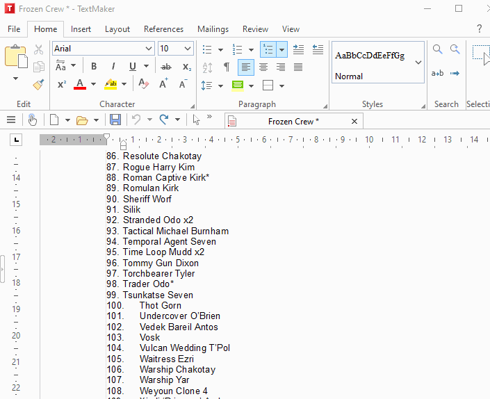

i'm makeing a numbered list, and when i got to 100 there is now a large gap between the number and start of the first word but not in 99 and below. can anyone tell me why its doing that and if there is a way to fix it. its almost like the program is adding in. A near "TAB" sized space between them. I included a picture of the problem

Hi, could you please post the file here? (or send it to forum(at)softmaker.de and include this URL in the email)

ok here it is

You can fix the gap using the method described in the animation below:

thanks for the help
