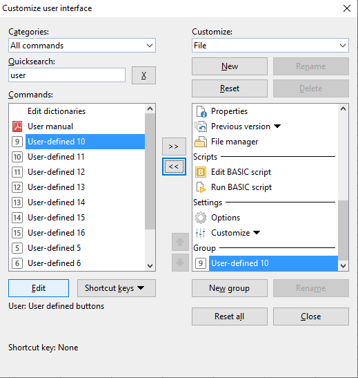

Jcrey2255 wrote: Fri Sep 04, 2020 9:47 pm Any update on how to do this?
Click on ribbon command File | Customize dropdown | Customize ribbon > in Quicksearch type "User", you will find several User-defined buttons, click on any one > Click ">>" to add button on ribbon > Click on Edit below > Update desired description > In command line type "BasicMaker.exe /s scriptnamewithfullpath.bas" where scriptnamewithfullpath is script file's full path and name > Press close.
You will find this new button on your ribbon clicking which will execute the script file for you.
