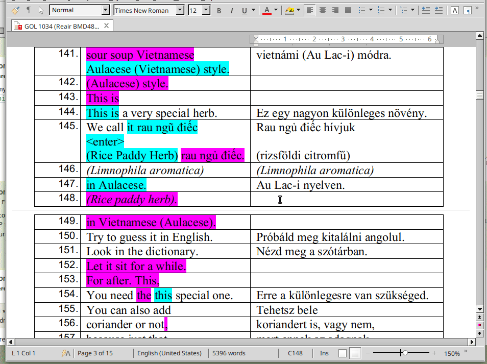

#2: just sent a file with a larger table to the email address. Is it possible somehow to increase the memory allotted to TM? Or would it help at all?
#3: Why to select part of a table: The same term is present in many cells of the table, but I want to replace all occurrence only in a certain part of the table (like in one column only), without going thru individually finding and replacing those. So it makes sense to select the column, but 'Replace' then does not work.

Thanks for sharing the file and details. I checked your file and tried typing at the end of the document. I didn't find any slow typing there. Please check the attached video of the test and please try again.

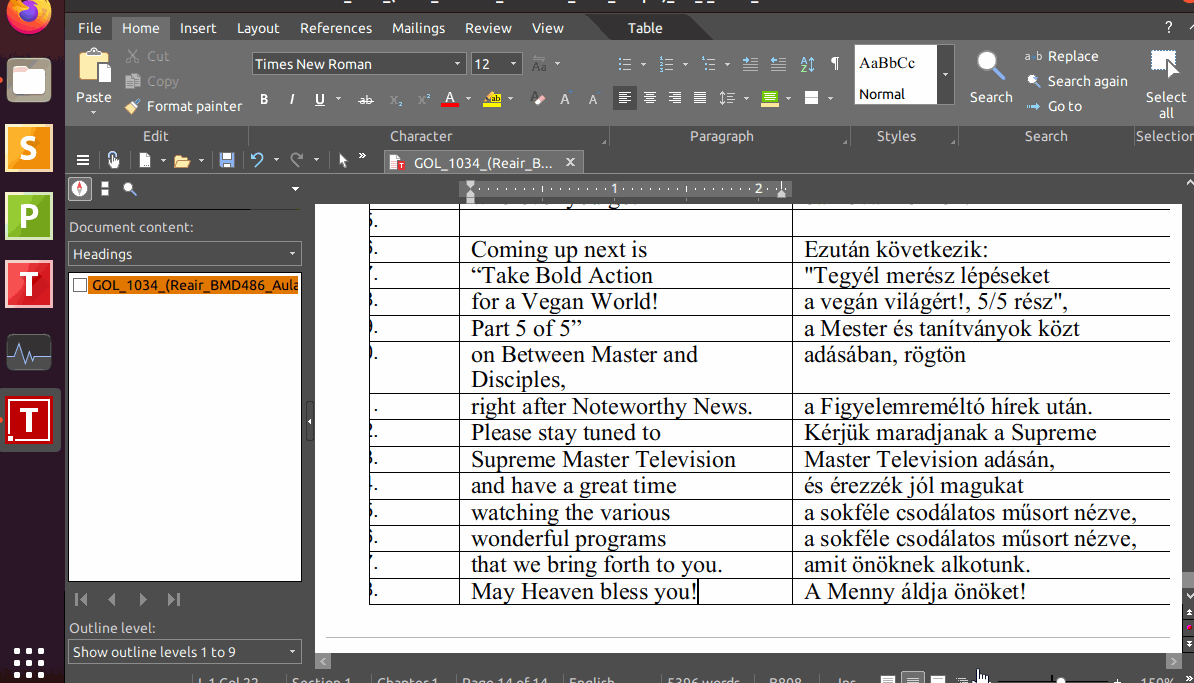

I installed Peek to record, I hope you can see. Typing at the end of the file I also did not notice any slowdown. But wen I started typing in the middle of it (page 4 of 15), then there was a very clear delay. When I stopped typing, it did catch up in a second, but the delay can be quite disturbing.
I know in MS Word it matters what View I use with these files. Page View is slow, probably because it continuously repaginates in the background. Draft View is fast. But in TM I did not find so far any difference between Standard View and Continuous View. It can be slow in both. Probably the longer the file beyond the point of editing (11 pages in this case) the bigger the delay, but I am just guessing.
