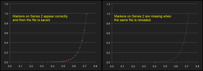

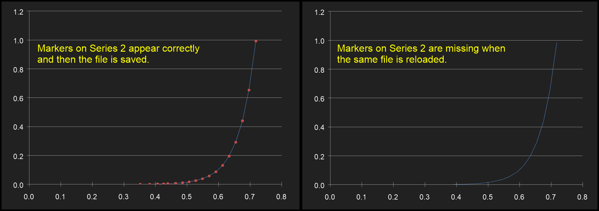

I've created a PMDX file that has a chart with 2 series plotted on it.
The markers on Series 2 don't seem to stay enabled after I save the file.
I've encountered this problem before on a different file that I had created from scratch. I must admit that I'm not sure if that problem had a specific cause/solution so I was surprised that the problem appeared on a completely new file today.

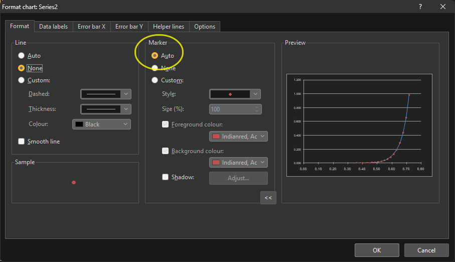

I think you may have misunderstood my original problem.
The problem is when enabling markers on Series 2.
They disappear after re-opening the file.
Your file has the markers on Series 1, which doesn't have that problem.
Because both series lie on the same curve, you can only select series 2 from the item selector shown here:
Re: Series markers disappearing
Thank you for clarifying this. I can reproduce it now and have forwarded the details for further investigation.
Our developer team has fixed this issue for the next service pack.
