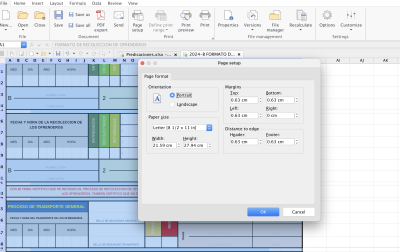

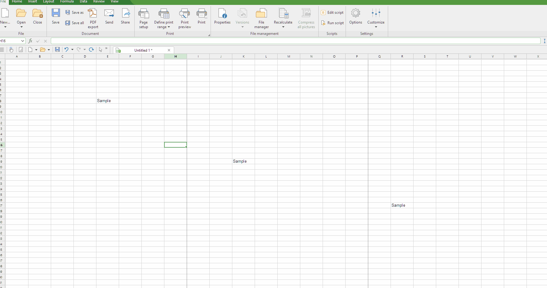

HI
I dont see any option that says GROUP PRINT.
If it is to click on print, it doesnt have any option either to print on one page.
Page setup doesnt have any button that says options anywhere.
Can you please explain further?

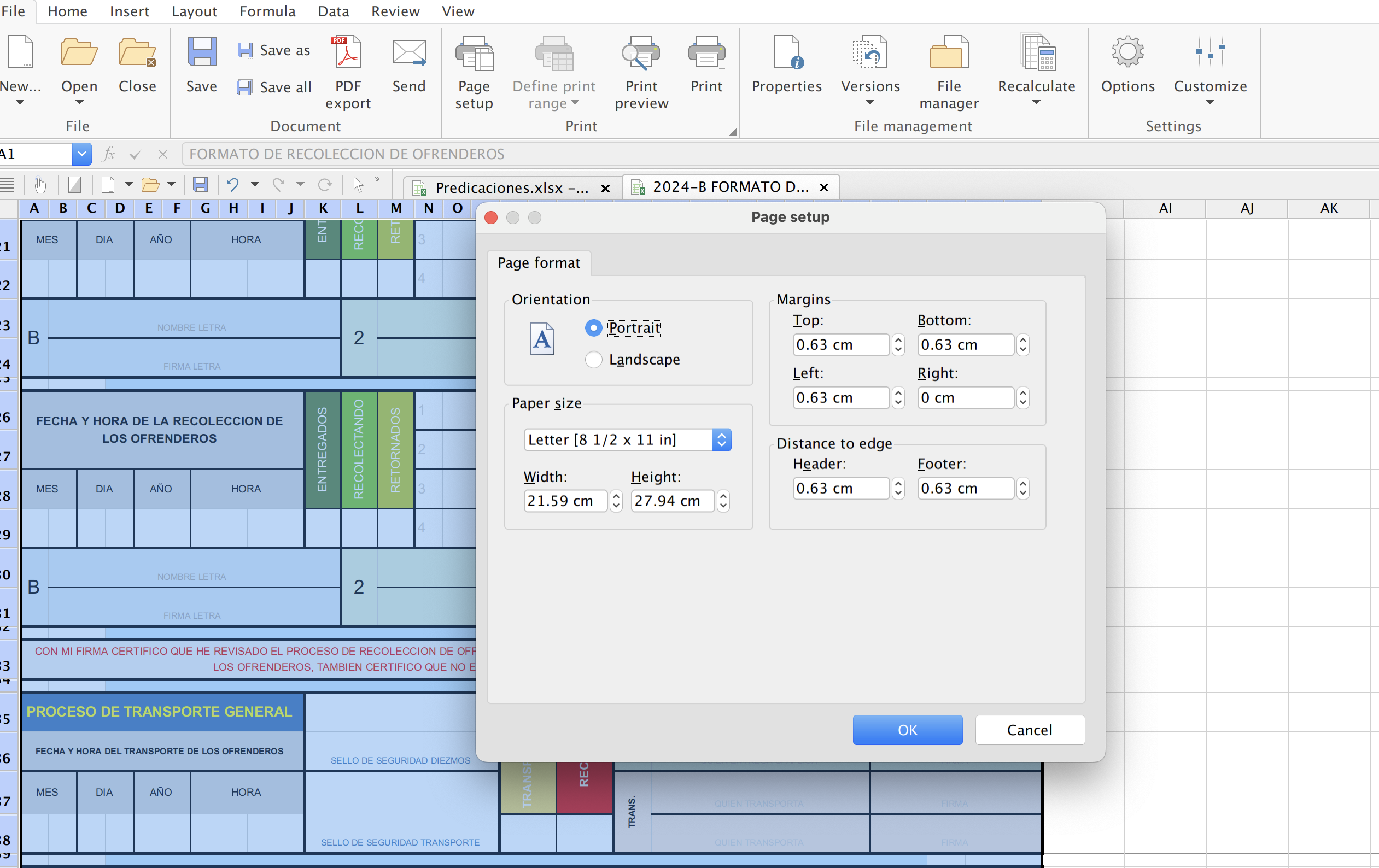

Posts: 3381
Re: Print all in one paper
Thank you for sharing the screenshot. For your reference, I have created this screen recording of the above steps to help you.
Please check this screen recording and follow the same.
