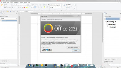

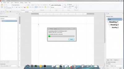

I am running the 64 bit portable version build 1024.Tried to update to the latest build (1030) but noticed the download says the 32 bit version was being downloaded. Obviously I don't want that, so I terminated the download. Tried again and got the same message.
Besides relying on a full install and make another portable copy, how do I update what I already have?
