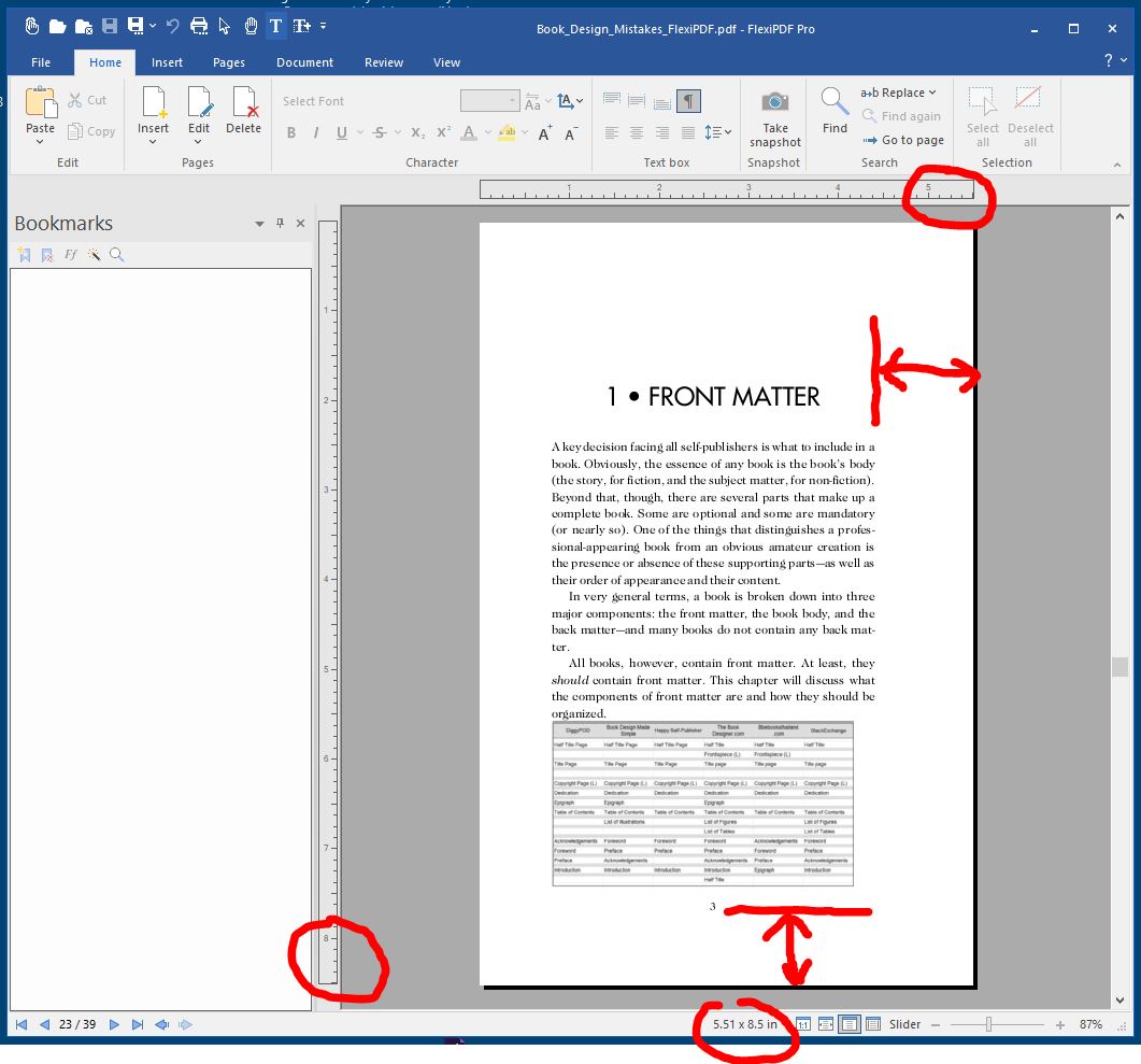

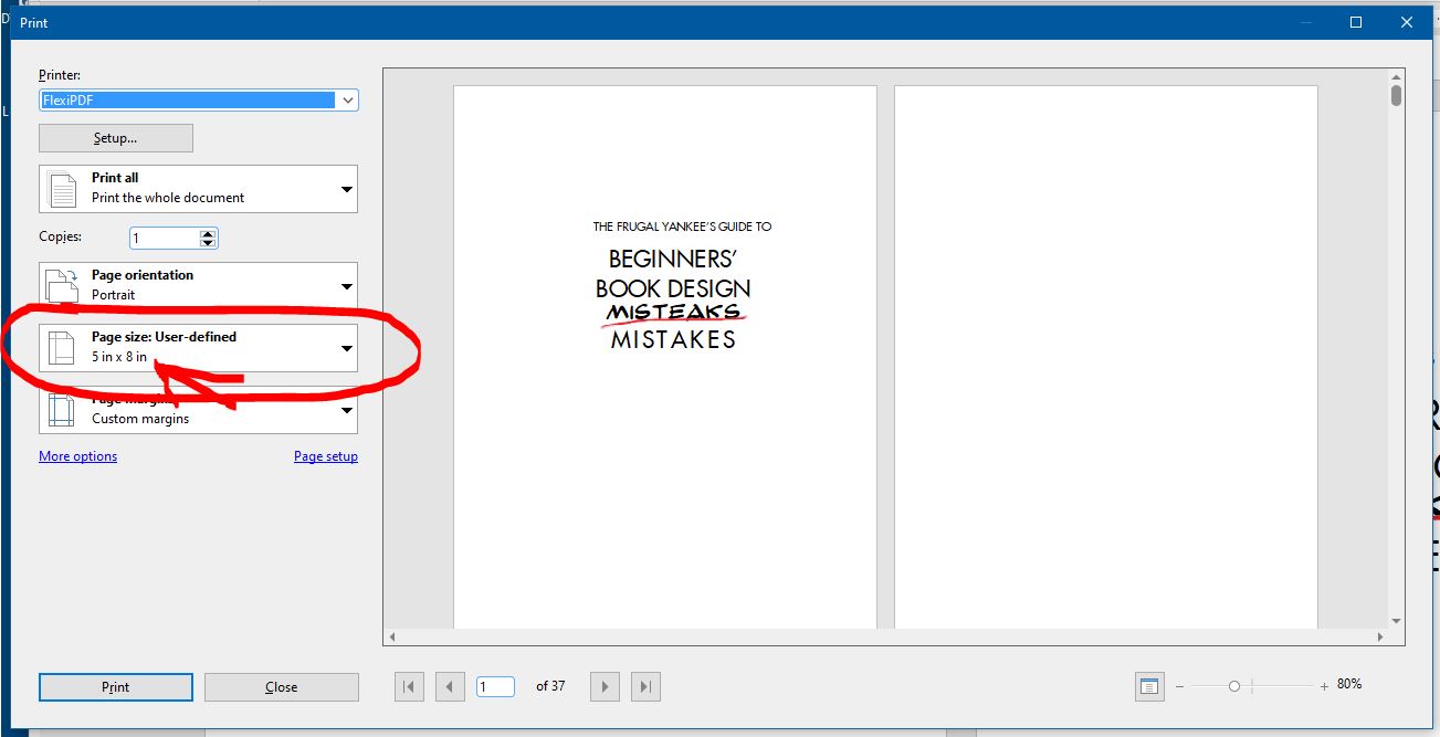

The file I used was a complete book. I re-created the issue using a sample book file. The book is formatted for a page size of 5 inches x 8 inches. Using the export to PDF from within TextMaker, the page size comes through correctly. However, when using the FlexiPDF virtual printer, although the print dialogue tells me the page size is set to 5" x 8", the resulting PDF is sized at 5.5" x 8.5" and the right-hand and bottom margins are expanded by the extra half inch.
As requested, see attached.

- Book_Design_Mistakes_FlexiPDF.pdf
- (240.33 KiB) Downloaded 1127 times
- Book_Design_Mistakes_Export.pdf
- (475.83 KiB) Downloaded 986 times
- Book_Design_Mistakes_5x8.docx
- (464.83 KiB) Downloaded 1157 times

Two more files ...

Thank you for sharing the sample files and screenshot. I can reproduce this issue and have forwarded the details for further investigation.
